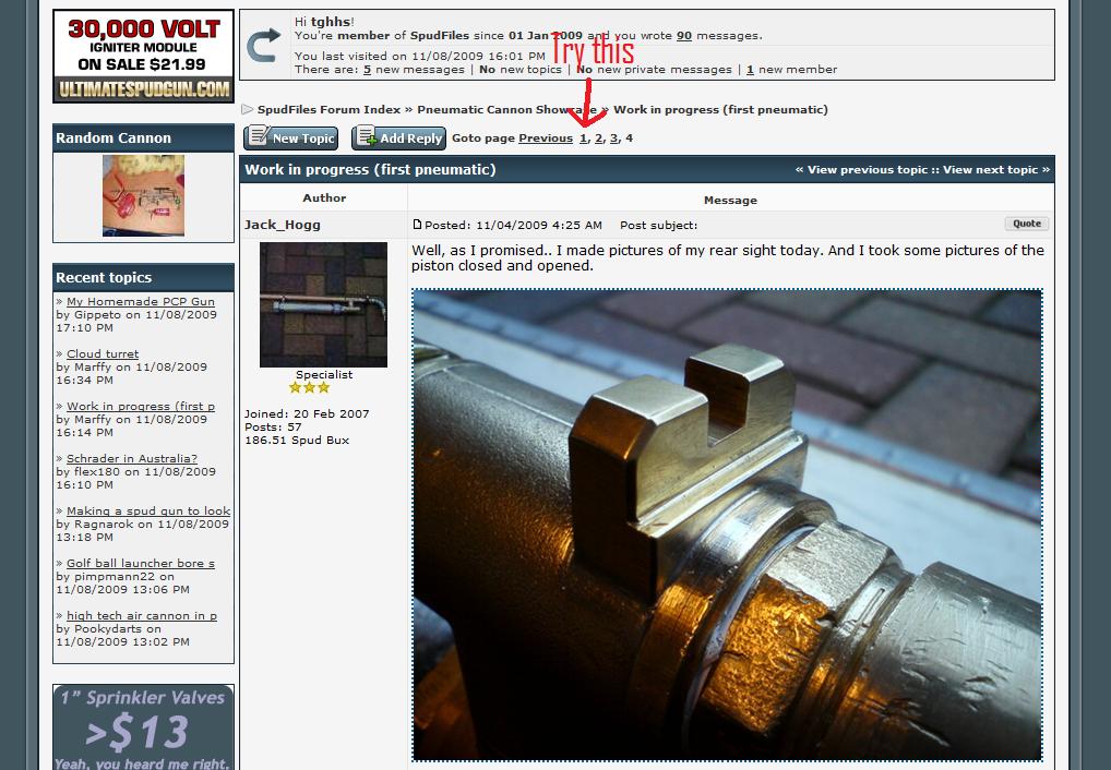

Well, as I promised.. I made pictures of my rear sight today. And I took some pictures of the piston closed and opened.

I have machined a 18mm porting for a 25mm (ID) barrel. That's the biggest porting possible for a ¾" Tee. The most I could get for this design.
jackssmirkingrevenge wrote:Again, beautiful.
If I could make an aesthetic suggestion, paint the steel parts black, polish the brass and copper and add some kind of wooden grip to cover the handle-
That's the look of the BTB sawed-off Mark3. I do like that look, but polishing brass and copper, will turn dull again after touching it. Also, I do like the brutal steel look for this design more. It looks and feels a bit more powerful. Just my personal taste... :roll: Well I am going to buy some thick heavy duty shrinking tube for the pistol grip and the resevoir.

Thanks BTB :) I didn't sawed off the barrel that much, becouse it would lost a lot of power. I have chosen for the looks of a compact and powerful design.
