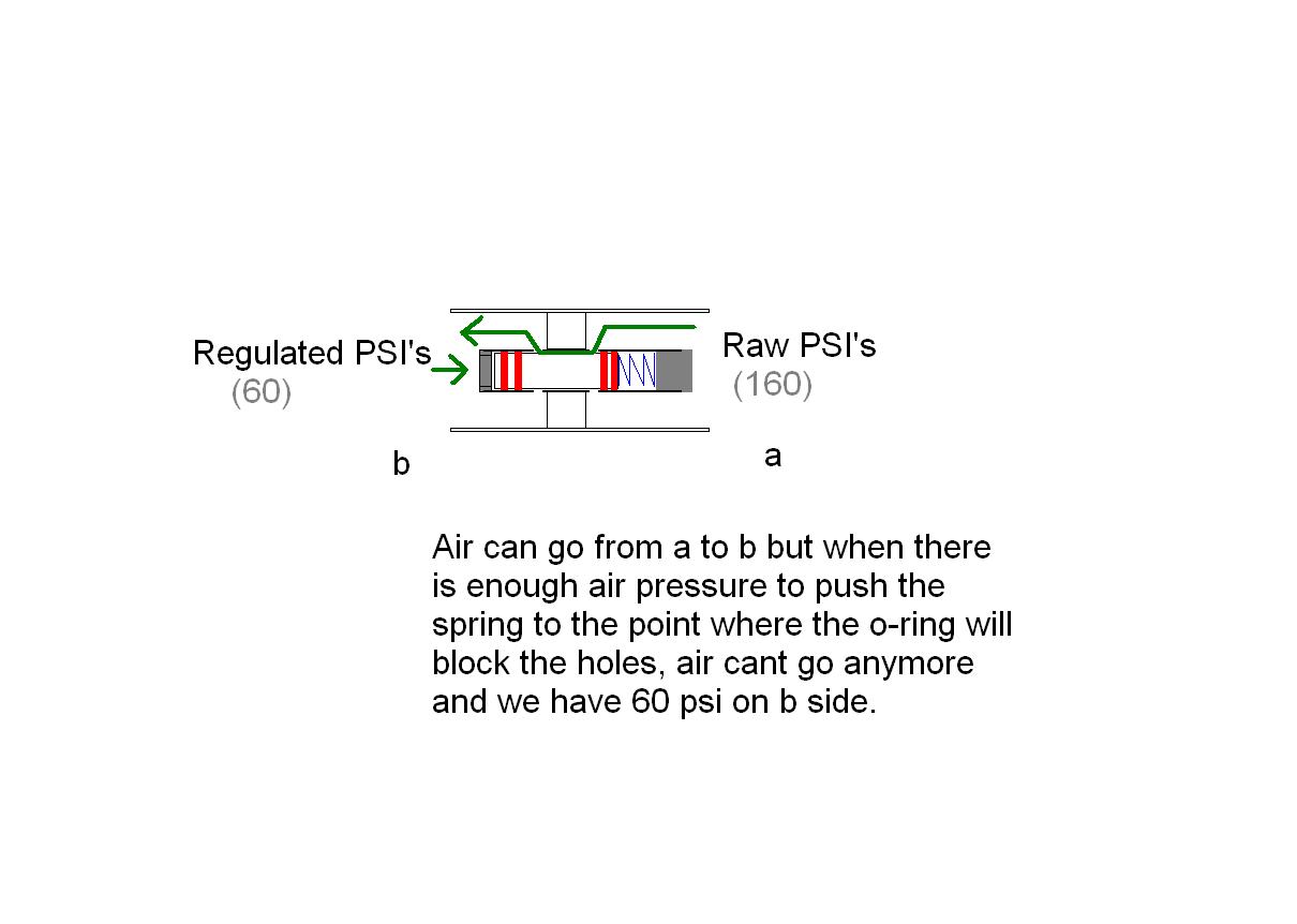

So here is my regulator, red is o-ring.
(Is there something that woul'nd make it work?)
The spring force will have to be tweaked with an air pressure indicator
Homemade air pressure regulator
I don't fully understand how it works either, can you explain a little more?

Its very simple, when there is 60 psi on the regulated side, the "pushbutton " counters the spring force, closes and no more air can go , so we have 60 psi.I don't fully understand how it works either, can you explain a little more?

I don't quite understand your drawing but, I think the spring needs to be on the low pressure side.
The theory is very simple: when there is 60 psi on regulated side, the valve shuts closed.
so that the valve closes when there is 60 psi on regulated side, the piston as to counter a spring to block the air that goes by the holes (green line)
When the piston is pushed towards the A side enough to block the holes with the o-ring, the valves shut and no more air can go to b side, so there is 60 psi.

hi demon
you design is not to bad but you need a venthole between the spring site of piston and outside of chamber.
the outsidepressure is the referencepressure.
hope you understand me here a quick pic (note it is not scale, show not on the squares)
note the 0psi area in the pic
by
- regulator.JPG (17.89 KiB) Viewed 16650 times
Thanks a lot Jean,
But i dont think that a vent hole is nescessary, as in auridruize, there is one, but it does'nt vents with ambient air, its stays in the airchamber.How can that be possible?
