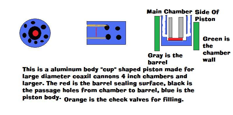

The basic idea came about in talks with Rabidduck about a 4" chamber coax cannon he's building. Because of the need/want to keep pilot chamber small and possible piston tilting with large diameter pistons, I thought the majority of the piston could be in the chamber.
This way the piston can be plenty long enough to avoid tilting and still have a small pilot chamber. The part of the piston in the chamber will be hollowed out to allow plenty of flow and keep weight down. With enough surface area to do the job.
I'm sure there is plenty of things this piston can be made from.
Anybody think of this before? I haven't seen anything like it myself, but that don't mean it's not out there all ready...
Cup Shape Piston
