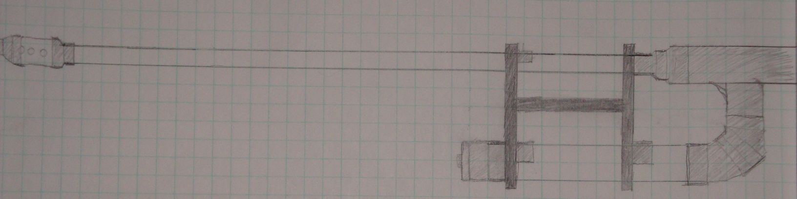

Cerberus, Guardian of Hell, was the legendary three headed dog from Greek Mythology. Cerberus is also the name given to our 3" barreled ME 1-05H (Howitzer).
The pipe comes in today for our largest build. theLesser and I have been designing a howitzer type gun for the past few years and have just now accumulated the resources to build it due largely in part by NGO's (such as friends and relatives sending Christmas gift cards to home improvement stores and such). The massive 6" switchback design chamber has a tremendous 1494 cu. in. volume. Combine that with a 10' long 3" barrel and you have a gun with roughly a 1.6:1 C:B Ratio. 500,000 volt stun gun ignition using a quite similar spark strip design Starman used in Triple Thunder. Using propane and/or MAPPro as fuel, and having dual chamber fans, we hope to fling water filled coke bottles and sabot ammunition as far as we can. Breech loading seemed necessary for a switchback design. We've sketched things out, made scaled down mock ups, gathered scaled down recoil data (for which we've accommodated), and have tested the 12v switch box and ignition system. Pics to come later today of designs, specs, switch box, and of the gun's chamber pieced together.
Here's an an early scale drawing.
