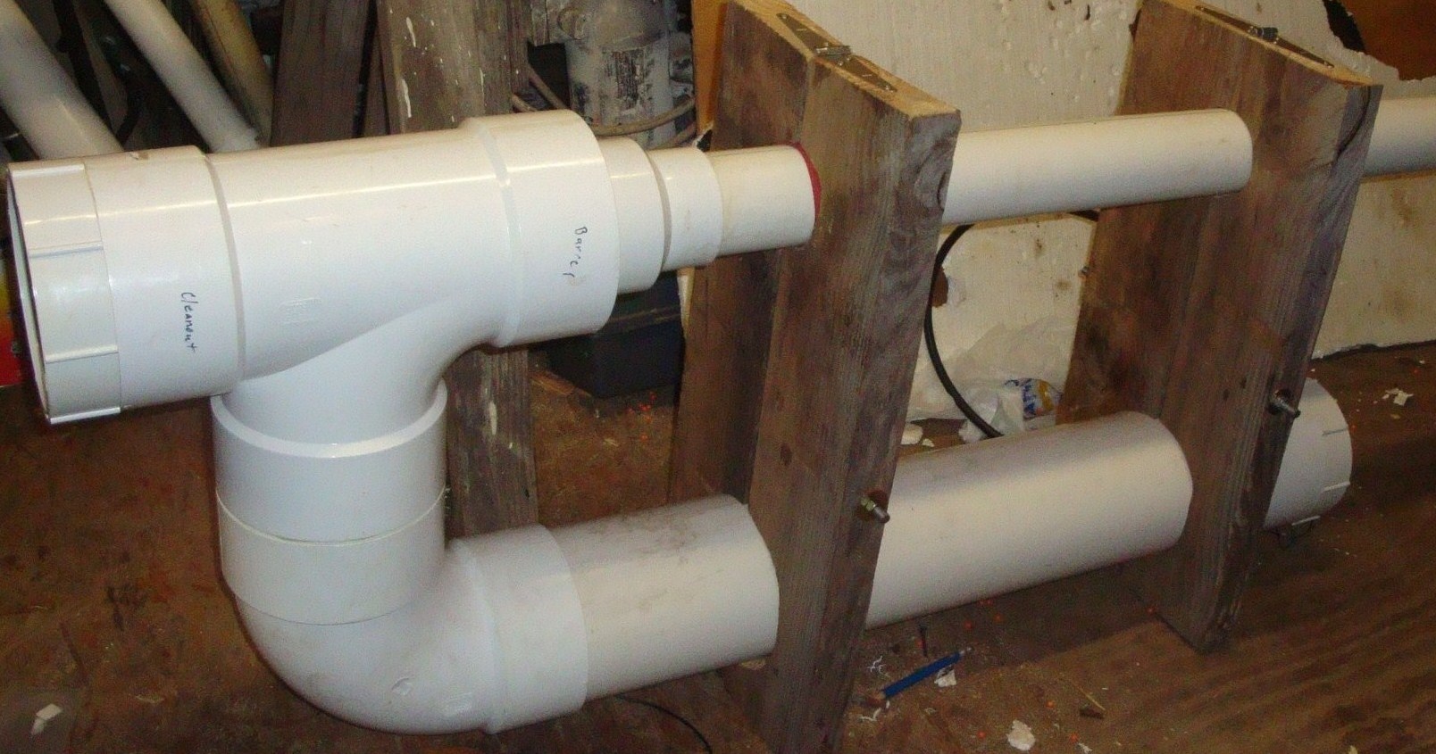

We've engineered the shock mount for this particular reason, so if the end plugs do pop off, we'll be to either side of it. Never directly in front or back. The whole chamber is in a channel of 1/2" plywood that is reinforced with 1x4, and 2x4 boards. We've covered our bases with safety in mind. The only part of the gun we will be partially exposed to is the barrel.
The pressure rated fittings will work. They are rated at 180 also. I would be very surprised if we see 180psi out of this thing, lets also remember that these are working pressures. Burst pressures are much higher.

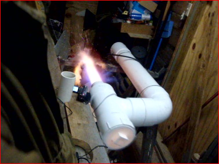

Video to be posted of the first firing of the chamber. Not only does it produce a substantial "pop," it also has some pretty impressive recoil (not to mention a 3' jet of fire). It's fairly nifty. Video to come (theLesser's reaction is sure to draw some lawl's).
Notice the flame.  You can't help but notice the flame.

Is it just me or is the clean out plug glowing? :D

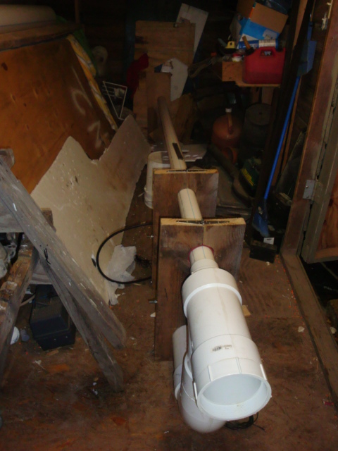

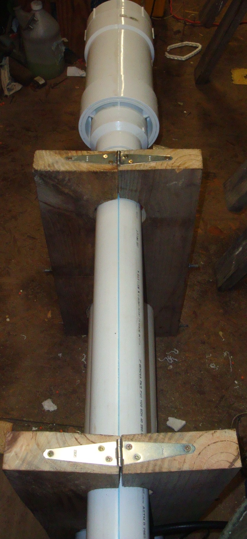

So the barrel is attached, finally. Our supports clamp on just as we had planned, and tomorrow sees the construction of the trough that all of this will sit in. This thing is a beast. We finally see the scale of this project.

jackssmirkingrevenge wrote:It looks like you're subjecting your cannon tomedieval humiliation ;)
Hahaha. Pretty much. It'll look even more like the stocks once we put the bracing up in between the two pieces of wood. However, once we get this thing on it's recoil rails, it should start to look less like PVC S&M, and more like a howitzer.
