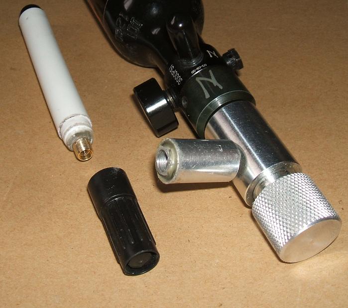

Some testing at 800 psi, it didn't blow up (yay!) but performance seems to be limited to 275 feet per second with 16 grain pellets. I expected a bit more, of course the 850 psi given by the tank is nominal and I have no way of verifying this output, and my "filling station" doesn't actually press the schrader stem, relying on pressure difference to crack the valve open, so of course some pressure is lost at that stage too. Using "modded" valve stems there wasn't much of a difference in performance, it maxed out at 283 feet per second. Not exactly a powerhouse at less than 3 ft/lbs but you don't want to be hit by it.
Here's a detail of the marker and the paintball tank attachment I made, using epoxy (what else?) and an aluminium car tyre valve cap.
