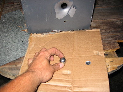

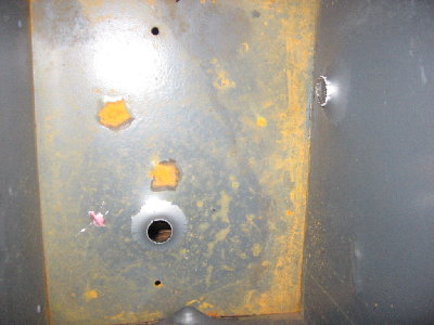

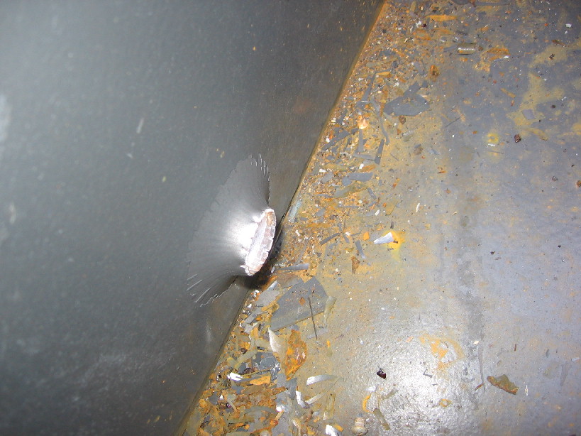

What?!?!? Don't pneumatics get to play???ThegunGuy wrote: When you find a combustion that can penetrate the quarter inch of steel using saboted darts my Christmas present can penetrate with a hollowpoint I will probably give up on magnum rifles and use that instead.
These shots are 1" ball bearings through 3/16" steel plate( a safe)....
