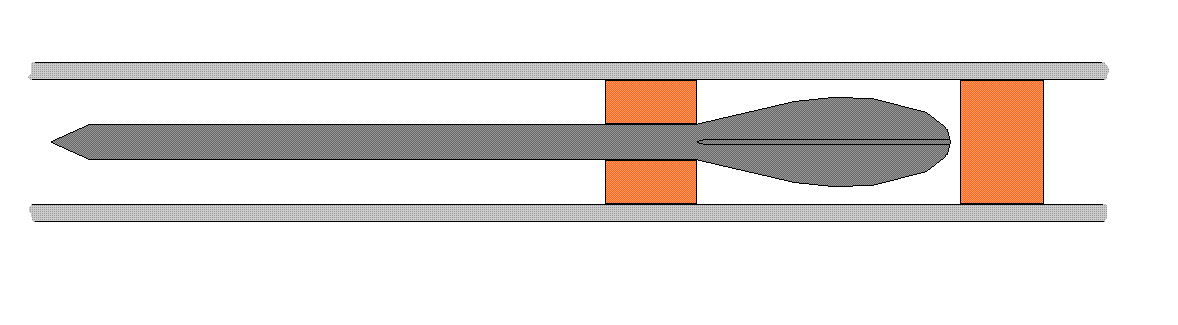

How about something like this, using say a 1/2" barrel and 1/2" dowel as a sabot. It comes in 2 parts, a simple half inch length goes to the rear of the fins, as a gas seal to push the flechette along. Another half inch length is drilled through the centre the same diameter as the flechette body, then cut in half and put around the flechette to stabilise it in the barrel.
As a lighter alternative to dowel you can use balsa wood, much lighter and easier to work with, and you can cut out appropriately sized sabots from a 1/2" thick sheet using the sharpened tube method (without cutting your fingers :P)

Of course! A gas seal AND a sabot! That is an absolutely awesome idea.
Did you make that diagram just now, the flechette looks exactly like the ones I ordered.
Thank you very much!
When this starts going together I'll post it in this thread.

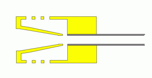

Probably not such a big deal, you could make an air stripper:
but a series of barrel ports should suffice, you could even sheath the barrel et voila, integral suppressor ;)

Great, I think I can make an air-stripper out of some fittings using a dremel.
spudamine
Posts: 184
Joined: Sun Nov 23, 2008 2:47 pm
Isn' t there quite a chance that part of the sabot wil get caught on the edge of the air stripper? a simpler muzzle brake with smallish holes might be a better solution.
