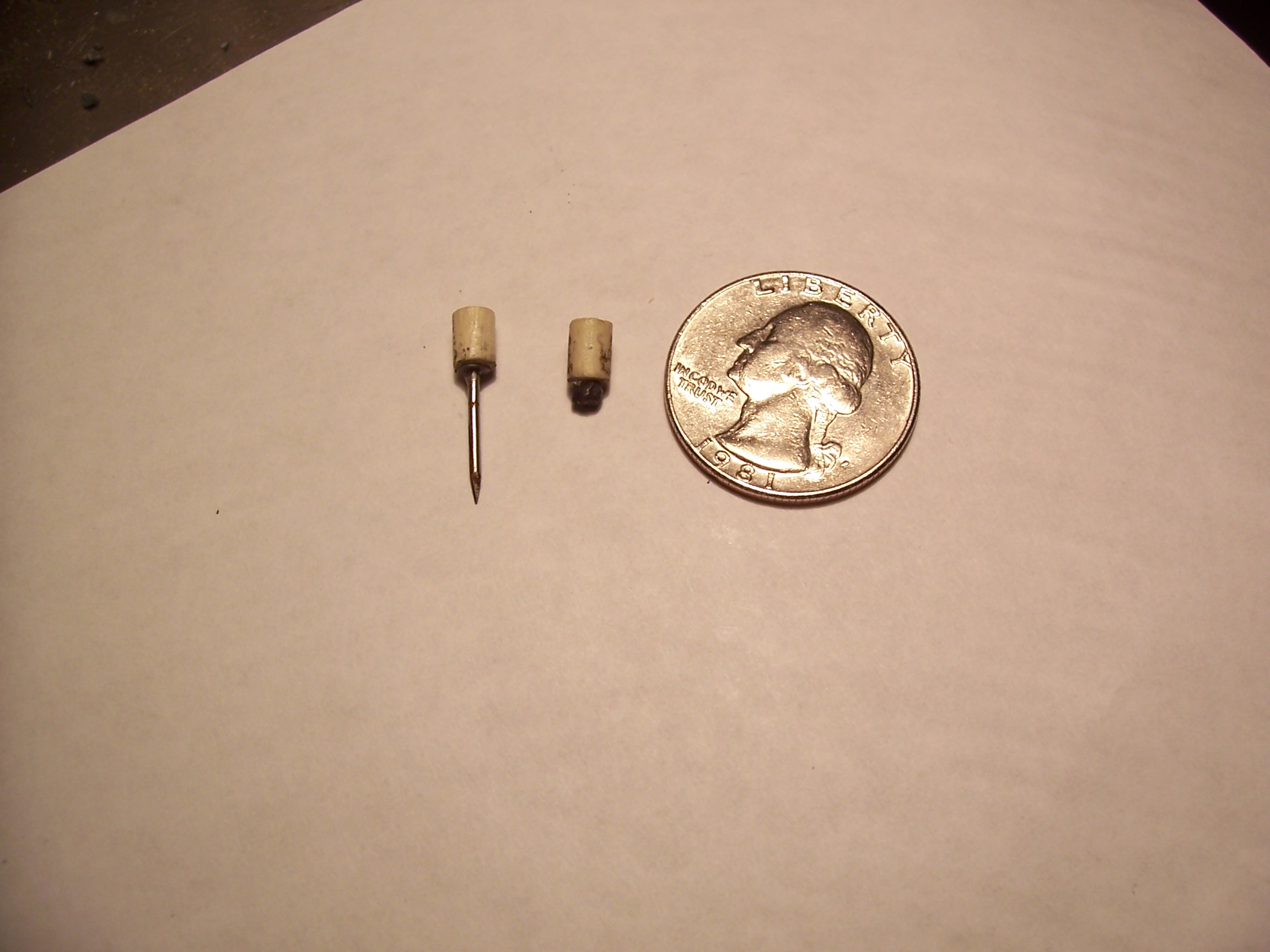

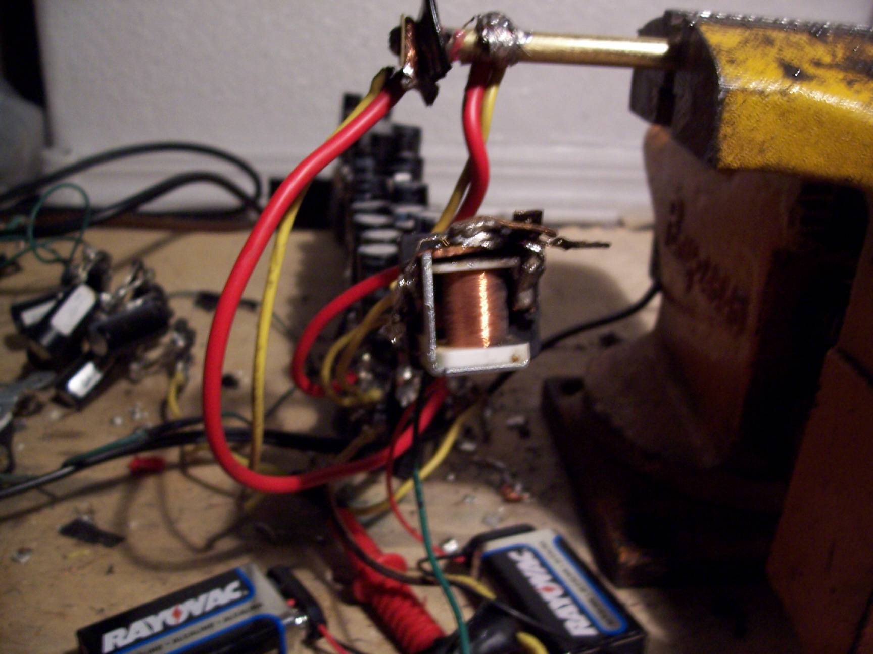

I built this out of parts I had lying around, the barrel is three brass tubes epoxied together, the electrode is a screw with an epoxy insulator. 370joule 660v capacitor bank. Switch is a 40amp auto relay with homemade contacts. The ammo is a wooden dowel wrapped in tape with a chunk of lead or a nail glued on the tip.

Kudos for making it work, what's the performance like?
The first shot was a soda can full of water at 270joules with the lead slug, the next shot was a lead slug with one slit cut in it like a dum-dum bullet into clay at 370joules. I lined up four pennies and the dart went into two of them and then curled back into the second penny and skewered them together.
