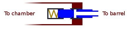

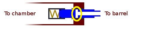

Lately i`ve stumbled upon the AirForce Condor / Talon, wondering about the huge amount of force needed by the spring to open the valve. So i agonized how to make life easier when it comes to hammervalves. This is what i came up with:
A mixture of BTBs pushbutton valve and Technicians QDV.
My main concern with it is wether the pressure at the outlet (see highlighted picture) will prevent the valve from closing or not.
Also i`m pretty interested in your general opinion and recommendations for better performance.

Area in question highlighted

Interesting thought, as long as you have a decent valve spring it should have no problem with resealing. Looks like it would be a little complex to implement though without the benefit of machining facilities.

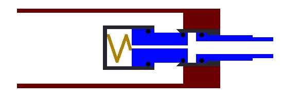

Well, i tweaked it a bit (theoretical) and thought about using the pressure for resetting the.. urm, the blue part (Can find the right word for it. Is it "poppet"?).
With this modification, the needed spring in the back of it must only be strong enough to close the valve in an unpressurized state. Pressurized the air/gas will hopefully do this job. May get a bit fiddly due to the small parts, but i think it manageable.

Just having a hole straight through should do the same job shouldn't it ?
Hm, i`m not quite sure, but i can see vast amounts of air rushing to atmosphere before the valve closes. But with well sealing ammo and a greater area in the rear part than on the front this could do it. Not to mention the lesser complexity :roll:

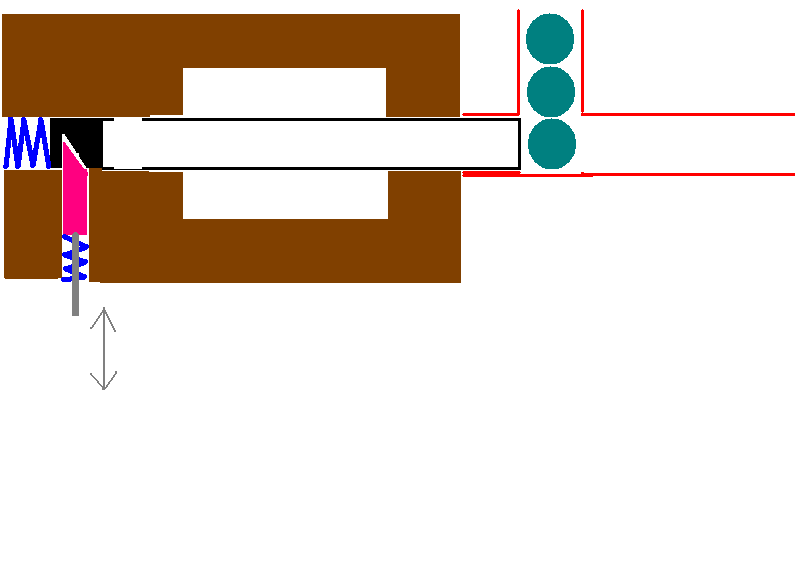

hmmm but wouldn't it be better if the valve opened when the barrel moves forward not backward ?
POLAND_SPUD wrote:wouldn't it be better if the valve opened when the barrel moves forward not backward?
In this case I don't think so, as it is the breech slot is sealed when the valve is opened, and the projectile will have left the barrel by the time it is reopened.
uhmm but the spool could itself could be the bolt that loads new round
also dwell time would be improved as pressure would act on it as soon as it opens
