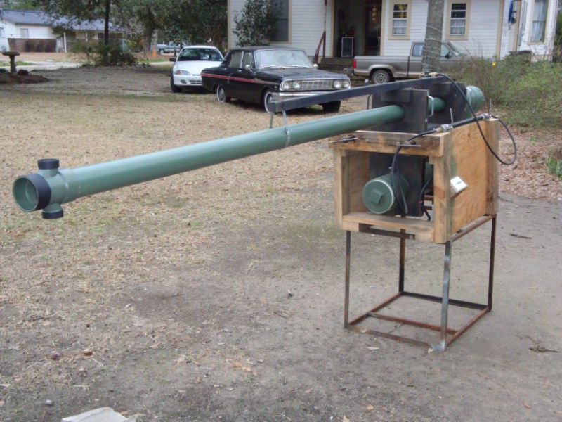

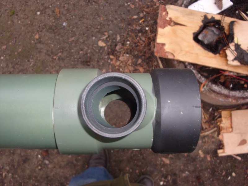

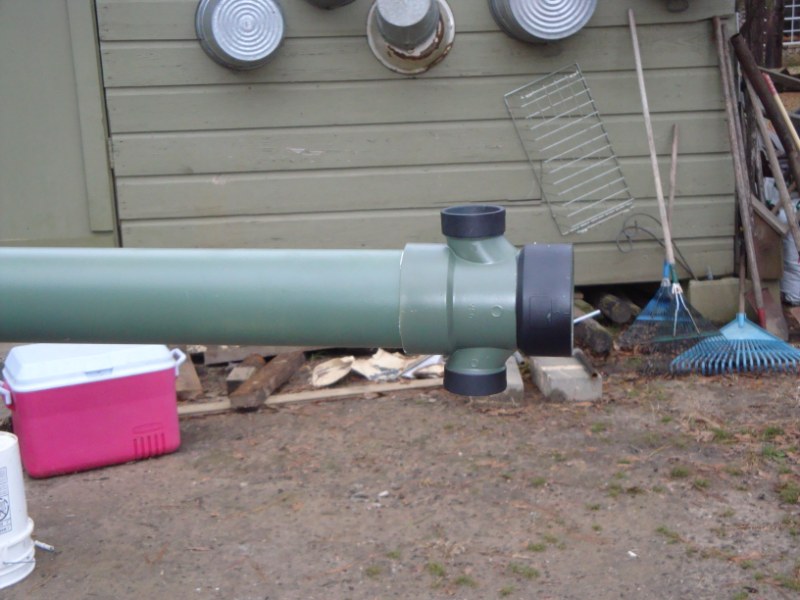

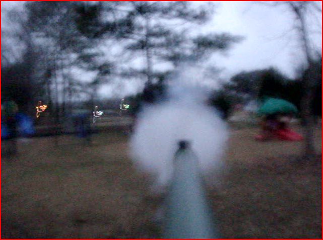

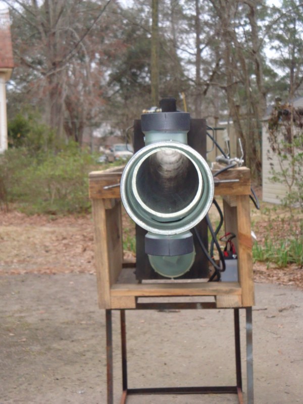

So we didn't get to work on a stand, but we did find one from our jet-kart project that worked-ish for what we need for now. This weekend we tried testing different propane loads. One at 70p.s.i., and one at 80 p.s.i. Of course we shot it twice at our regular load of 75p.s.i. and got the first visual understanding of how our muzzle brake works. Unfortunately the high speed camera was dead and the charger had been left at college (sadtuba), so we took a still from a regular ol' camera. Here's some pics for your viewing pleasure.
At least the base model cannon is 100% complete now.   The 1964 Fairlane in the background is for sale.
From the muzzle.
From the muzzle.
From the top showing the ports.
Muzzle Brake.
Muzzle Brake.
Notice the vertical plume coming out.  We fired a rag soaked with water, so it isn't smoke, it's water vapor.

So as to further the proliferation of the spudgun, We may be using our monster cannon to help local high school students understand the properties of projectiles. I have e-mailed a physics teacher at a local school with a challenge. Four teams of students will have one or two weeks to construct a projectile with distance and accuracy in mind. After the competition, we'll let the students choose whether or not they want to put their projectile through various materials (plywood, old electronics, etc.).
New stand design.  Towable with the pivot set toward the rear of the cannon.
Stand Setup II..jpg (30.4 KiB) Viewed 6844 times

I've looked at your muzzle brake and I think that it would be more effective when you turn it around. The two exhaust ports bend against the blast direction. In the opposite direction they would catch more of the blast energy IMO.
McCoytheGreater
Posts: 191
Joined: Tue Dec 15, 2009 1:10 am
Location: Mississippi State
With the muzzle brake in it's current configuration, the exhaust gasses are redirected backwards so it "propels" the gun forward reducing recoil. Much like this on a .50 Cal.
Last edited by McCoytheGreater on Mon Feb 08, 2010 5:47 pm, edited 1 time in total.
MRR
Posts: 361
Joined: Tue Feb 17, 2009 2:29 pm
It looks to me like the black tips on the exhausts direct the gases at a 90° angle to the barrel up and down and not backwards.
