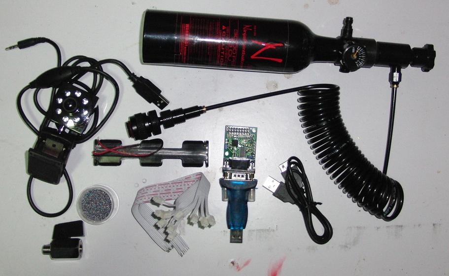

Well, the first bit of hardware is finally here :)
For work to begin on the turret though the postman still needs to get me the following:
Serial-USB adapter <--- edit: arrived
Elevation and traverse servos
Battery box & associated wiring <--- edit: arrived
Webcam
As to the gun itself:
Trigger servo
1/8" ball valve
Webcam
1mm BBs
I'm not sure if my local hobby store stocks 1mm I/D tubing for the barrel, if not I have some nice 1mm diameter piano wire that will make for a good casting. Looking at that wire made me realise how small the calibre is and how pathetic power will probably be at more than a couple of metres distance. This isn't a problem though, the program is really only good for a fixed range as it sees in 2D and therefore cannot make appropriate adjustments for windage and projectile drop anyway.

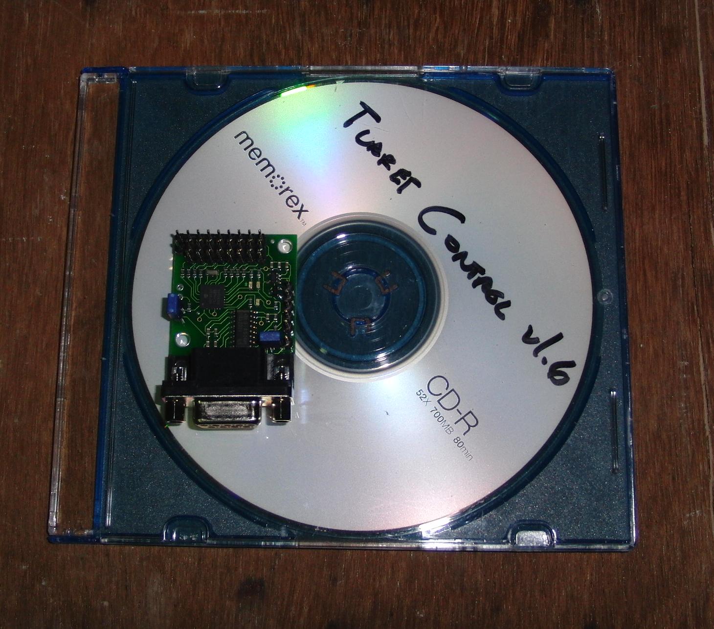

rp181
Posts: 1090
I think it could. On that board, it seems all there is is a RS232 interpreter (can be had for $2 or sampled) and a mux.
