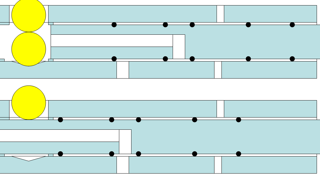

The search for a semi-automatic valve has continued for a long time. Several members on this forum have made advancements in the area producing more and more valves which are capable of functioning semi-automatically feasibly.
Based on many previous designs(I would like to point out especially Poland_Spud's ideas have helped me a lot, though other members' ideas have contributed to this idea too), I designed a valve which incorporates all aspects needed for semi automatic function in one compact block of material. I hoped to give the forum a working example before 2010 however found that my agenda was too full and thus have not yet finished the build. Nonetheless I uploaded an animation of the valve's function. The animation is fairly self explanatory(and I thank JSR for the help in making it), and I am happy to receive all criticism, advice and opinions on the valve.

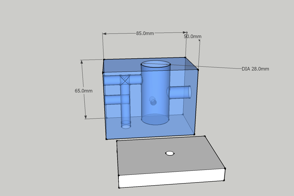

I've long thought of making a sliding block design, here's one I had come up with using an eccentric cam to operate it for full/semi auto:
The need for perfect sealing always put me off though.

Looks like a workable concept, john, but where are the O-rings on the rod.
Other than that, I think it will work. If you wanted to get fancy with larger designs, you could use pneumatic cylinders to actuate the rod.

Its nice to know I'm not alone with my concept, as they say "great minds..." I'll spare you the rest.
Now the sealing problem is a large one, though I assume the problem could some how be solved. Insomniac suggested I use a concept similar to that used in boats for sealing around the propellor shaft, called a stuffing box. It uses a tight fitting shaft and grease to make a seal. I am sure with low pressures and a large distance between ports, along with very tightly fitting parts this could be used my design too.
As for the O-rings, i thought they were so obvious that everyone would imagin them there, but as you point it out, I'll go put them in.

that's a pretty good idea
criticism...
you should try to achieve the highest speed of the rod/spool as possible to achieve short opening time but then it must stop instantly.. though I think it can be worked out somehow
I've just noticed something... if you want to use orings all the ports have to be on different levels... meaning that they cannot face each other as air can leak around the spool
this means that your valve would have to look exactly like any DCV spool valve
look here clicky (it's in a .doc file... have a look at the pic showing a 3 way valve there)

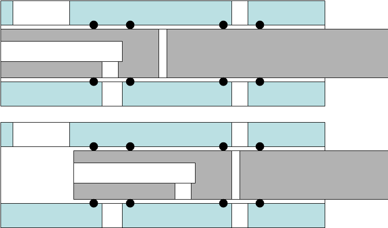

A couple of months ago I drew this
as you can see this was only the main valve but I am sure you could find a way to incorporate a simple loading T + air cylinder there
criticism...
as you can see this was only the main valve but I am sure you could find a way to incorporate a simple loading T + air cylinder thereyeah I agree that would simplify a lot...you could use pneumatic cylinders
- this is a slight mod of that design..
I know it should be easier to machine than the design I mentioned in my other post and still keeps all the advantages of that one... uhmm let's jsut say that's one of my alternative designs - valve+loadingmech.PNG (28.86 KiB) Viewed 6353 times

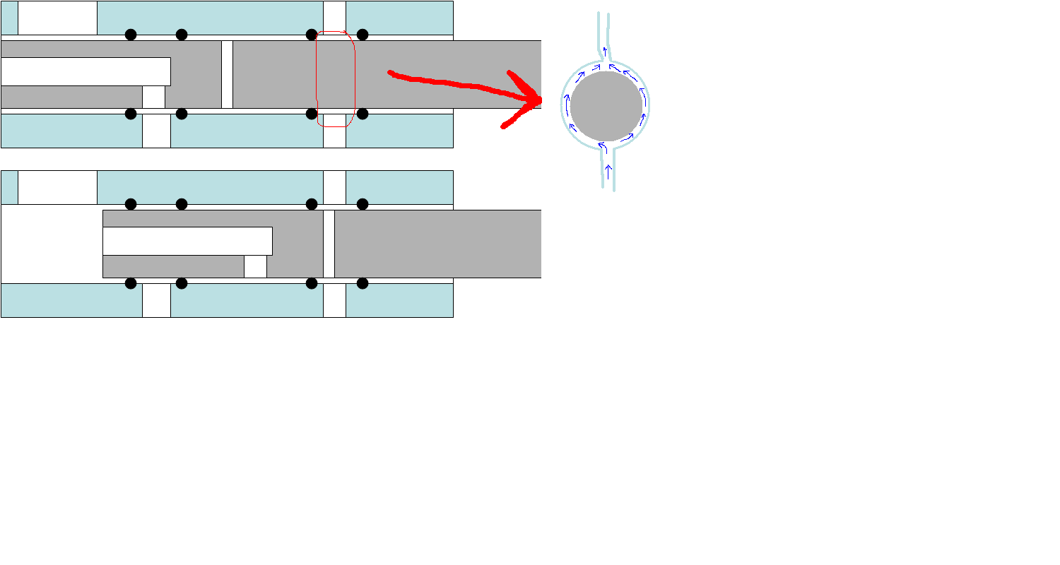

After another little think a while back I though the following may just be a better idea. Instead of a spool that moves up or down, it rotates instead. It has advantages, such as I can keep it in a closed system(less worry about leaking to the out side), with only one O-ring to seal against the atmosphere where the spool attaches to some sort of triggering mechanism. This is a rather crude idea, but really I am in the search of a simple "All in one" valve, and bouncing ideas back and forth is always very productive.
I assume using a gas cylinder would simplify matters, but really I am looking for a solution with few moving parts, which can be constructed quickly and easily and is not pricy. Though a gas cylinder could be made for little money it makes manufacteur of the valve a fair bit longer and also increases moving parts, which means more can go wrong(especially with a hydrolic/pneumatic cylnder which needs to be leak free, this is always a problem to achieve) and so I would rather avoid using pneumatic cylinders and the like.

that first design wasn't so bad but you have to seal it somehow... if you use orings there will be a small bap between the spool and the housing and air could flow through that gap...
that's infact how all the DCV spool valves work.. air is free to flow around the spool but not through o-rings that's why the ports have to be on different levels so to speak
you could try to seal it without orings... more less in the same way as the DCV valve that I use on the MKIII...
the valve has no seals as the spool is machined very precisely so that it's OD is very close to the ID of the housing where it moves.. with a bit of oil it seals perfectly
though it all comes down to whether you can machine it so precisely
when you've got a valve that moves up and down all you need is to use an air cylinder and a small 3 way valve (both of which can be bought from ebay for under ~15$) and you've got a pretty good and compact way to switch the valve
I think it would be more difficult to seal it and switching the valve would be slightly more difficult too...Instead of a spool that moves up or down, it rotates instead

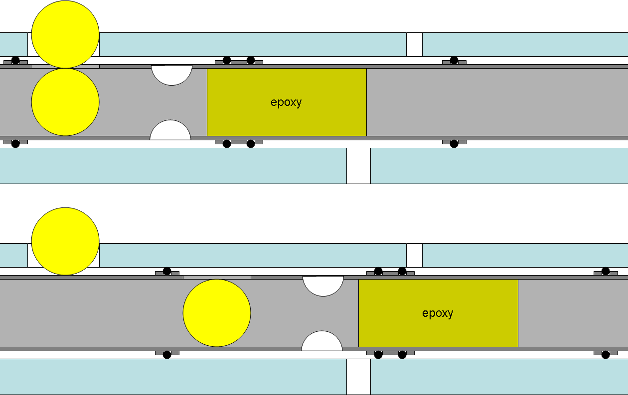

Its a pitty the original desin would not work, but it seemed just a little too simple...
I assume that with a VERY tight fitting spool and heavy grease i can surely get it to work. The question until what pressure is one left to be answered.
Perhaps with very high pressure applications the entire system could be put into a bath of heavy oil or grease, so that the leaks are really reduced to a minimum.

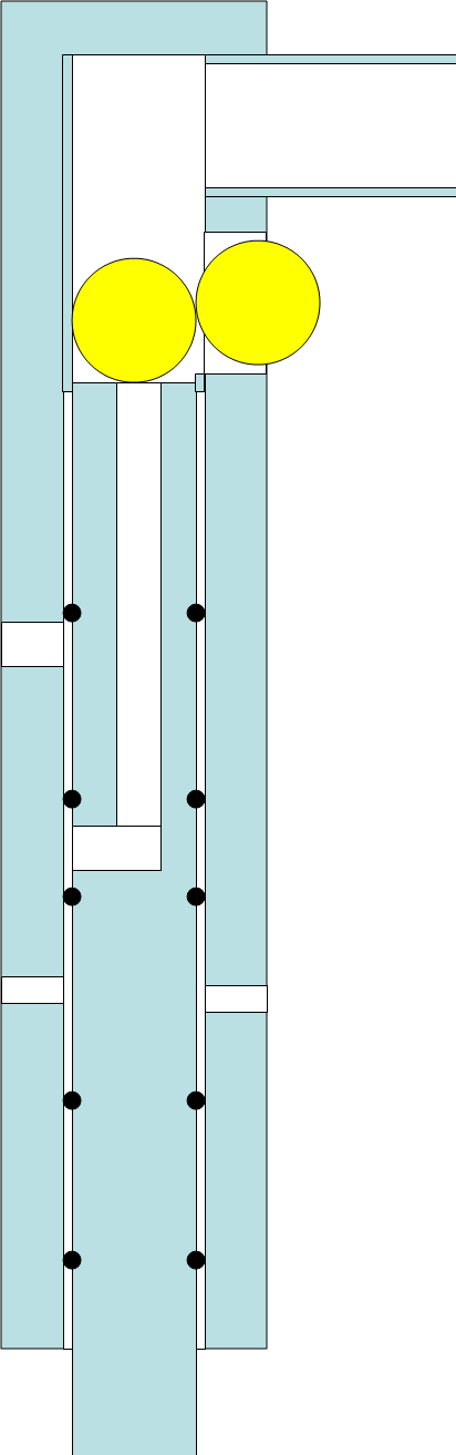

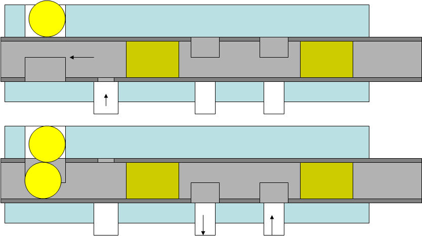

well you could always try the idea I posted here... I think this could be built using only a drill press .. the spool could be built from a threaded rod, nuts and washers with o-rings in between
- loadmech.png (34.4 KiB) Viewed 6304 times

is it really that hard to come up with these designs
why are you so persistent on a elevator mechanism,
also rotating valve have been mention many times before but no one has figgured out how to make one, if you can actually construct one then I applaud you
note in your designs it probably would be best if the valve were not opened until the the projectile can exit the barrel other wise you would waste air
- if you can make rotating valves then there are worlds of potential
- integratedsujestion5.PNG (17.88 KiB) Viewed 6270 times
- or if you can manage to do orings grooves in the walls you try designs like this
- integratedsujestion3.PNG (13.34 KiB) Viewed 6270 times
- how about a sliding barrel design
- integratedsujestion2.PNG (37.98 KiB) Viewed 6270 times
- but if you insist you can just turn a bolt design 90 degrees
- integratedsujestion4.PNG (20.16 KiB) Viewed 6270 times
- why are you so fixed on elevator designs, when classic bolt designs work
- integratedsujestion1.PNG (24.71 KiB) Viewed 6270 times

lol you've just missed what I've mentioned in two posts.. ports can't be on the same level
anyway apart from that nice drawings... do you plan to build any of them ?
the more I look at the design I modified here the more I like...
the valve itself does not load ammo... there is an air cylinder to do this... for some reasons it might be better to have a separate valve and loading mech. but both of them are still housed inside one part... also notice that this design does not require much precision...
is there anything wrong with it that I missed?
- lol.PNG (31.61 KiB) Viewed 6257 times
