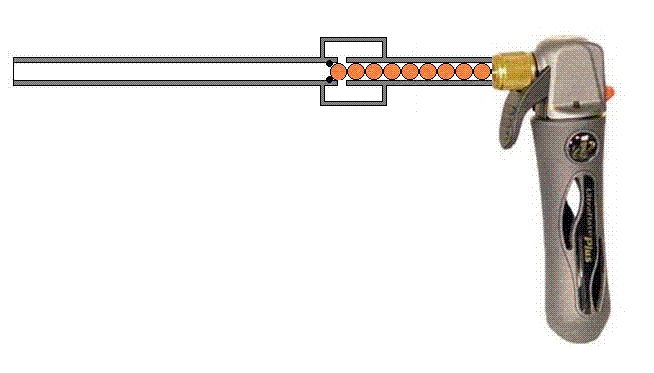

The plan is to hook it up to my shock pump tomorrow afternoon to see at what pressure the BB will "pop", then try it out with the chamber.POLAND_SPUD wrote:hey that's nice... can't wait to see it
Well... everywherewhere do you get all those springs from?
I'm sure you can buy boxes of assorted springs though.
Unfortunately the power was out at home yesterday so I wasn't able to do much testing but I hope to have some results by this afternoon. There might be some issues with sealing at the breech because I probably used the wrong sort of tubing but I will remake it if that is the case, if we can come up with a simple barrel/magazine design that will work well with a CO<sub>2</sub> inflator it will make portable pistols available "to the people" for all those who don't have the benefit of easily obtainable commercial airguns, so worth the effort
edit: As I suspected, the BBs aren't sealing properly in the breech so not enough pressure can be generated to fire them. Time to start over, but probably tomorrow, I want to play with my camera

I think it's not a matter of pressure but flow, the gas comes through a port that's around 1mm (or less, I don't have it in front of me but it's tiny) in diameter, it's practically leaking through into the chamber, which is why some sort of detent is needed to hold back the projectile while enough pressure builds up behind it for decent power.I was sure these inflators somehow regged the pressure down to 100 psi which would explain the weak power?
You could always drill it outdjango wrote:unless these inflators can be modded?......
Edit: Also, the guys in the video you posted are firing through a schrader, so flow is even more limited!
I'm thinking of making a simpler version that removes the need for a tee magazine and spring:
- inflatorpistolv2.GIF (15.32 KiB) Viewed 4596 times

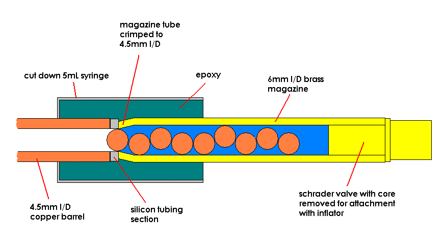

Or you could reload through the muzzlewith that latest diagram you would have to take the barrel off every reload

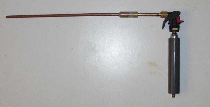

Now that the camera battery is charging I found time to make a prototype, I included a diagram of the actual construction below. I tried to make it as simple as possible, let's hope it works
