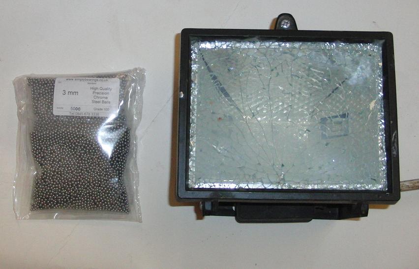

After my reasonably successful micro BBMG project I thought I'd give the smaller calibre another go with a ball valve trigger, initial results are very promising though limited as my SCUBA is due for refilling. Methinks I'll ramp it up from "submachinegun" to "assault rifle" with a longer barrel and tighter seal to reduce ROF somewhat, watch this space

so what was it ? 1mm or 3mm calibre ?

Did I bother making titles for nothingPOLAND_SPUD wrote:so what was it ? 1mm or 3mm calibre ?
I'm waiting for this to arrive before making the 1mm one.

That's the thing, you need high speed footage to really appreciate the action. In real time it was BRAAAAAAAP!!!!psycix wrote:That looks impressive (on highspeed)
That's for the sentry gun, I think it makes sense for reasons outlined here. Single shot testing with 1mm BBs at 800 psi have been relatively promising, it will go through both sides of a beer can or embed itself in plywood1mm?!? thats called a sandblaster.
I had something worse in mind actuallyC'mon, 6mm BBMG!

I don't think it's the best idea really... well it would be cool but that calibre makes more sense for semi-automatic fire or fast semi-automatic fire but certainly not for a full auto gun... you'd need a lot more air for thatI had something worse in mind actually
.20" cal or 6mm bbs should offer plenty of power while they are considerably cheaper and consume less air per each shot
you could even built the first gun using the full auto valve of my design

I've been watching some silly American propaganda, I think I will stick with 3mm calibre (just got another 10,000 rounds
), but the time is ripe to make a gatling type BBMG...

Haha, I disturbed and amused in equal measures at the idea that you "self-checked" while postingBrian the brain wrote:Nope..they're still 16 mm...
The flow into the BB chamber is going to be at the very least 100% of the flow through the barrel (using a 5mm ported ball valve) and there will be no seals or detents so ROF should be as high as it can get1mm sounds very promising. That would make a true raygun especially if you crank UP the ROF.
