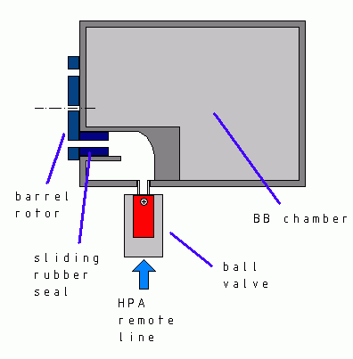

Assuming a BB feeds every 0.02 seconds from a typical vortex block, the barrels spinning at a relatively low RPM (say 1000) should not cause feed problems while still allowing a suitable high rate of fire.
As to barrel-chamber sealing, I was thinking about something like the attached diagram, having a sliding "piston" through which the ammo would travel, held in place against the rotor by pressure differential. This would of course cause friction but if anything it will help keeping the revs down
This is the beauty of working on a smaller scale though, projects that would otherwise seem out of reach are suddenly a lot more feasible, and using HPA small doesn't necessary equal weak.
Problem... or opportunityYes...that would be a problem

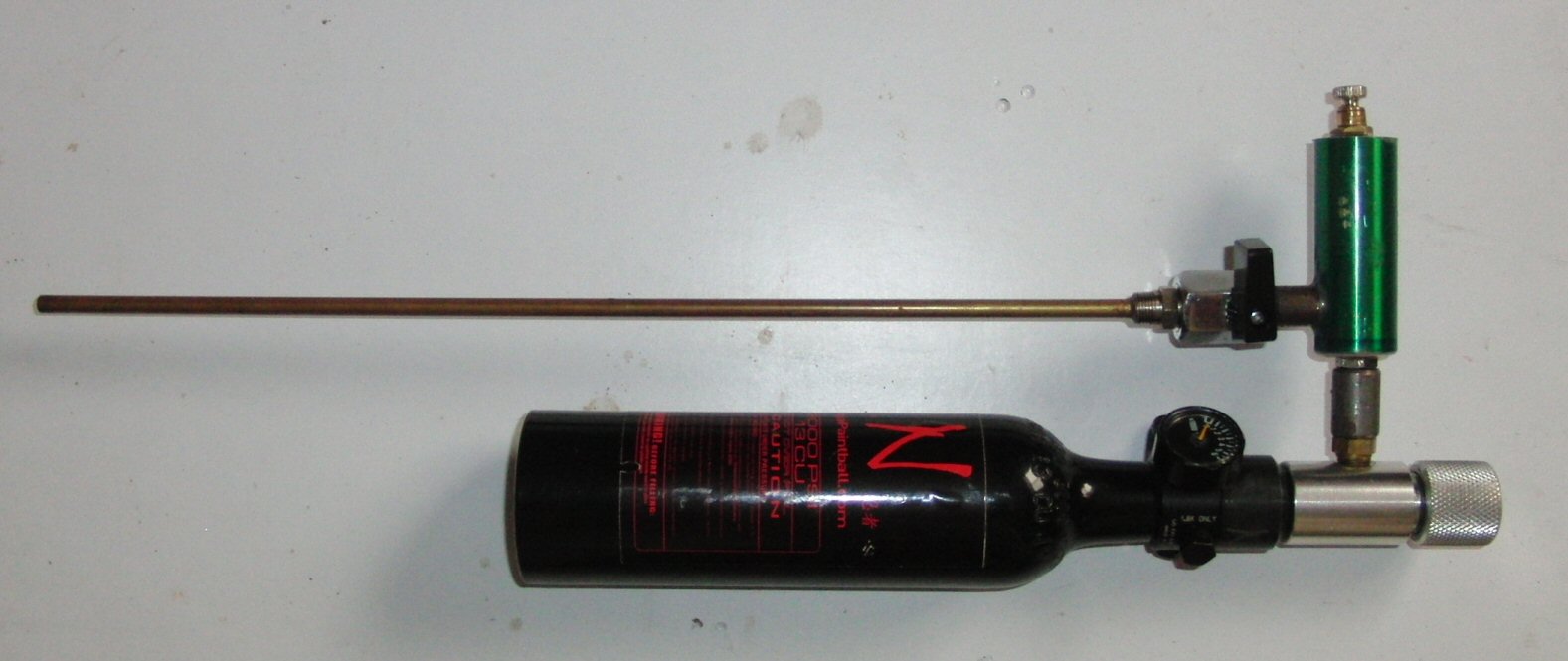

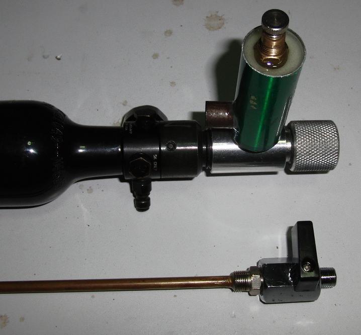

I've revived this concept using an idea I had proposed to Brian back on spudtech while discussing an efficient design for a marble machinegun, it's basically a variation of the "valveless" idea where the ball valve replaces the detent:
I'm using a 1/8" (5mm porting) ball valve this time around to avoid the jams that plagued the first prototype. The seal at the breech is necessary in this case as the ball valve is no longer sealing properly having been damaged with jammed 1mm BBs in a sentry gun prototype. The advantages of this setup however is that you need a lot less ball valve movement to fire as it is effectively only acting as a detent, and of course the tight breech should reduce rate of fire.
The prototype is curing, testing after at least 24 hours:
