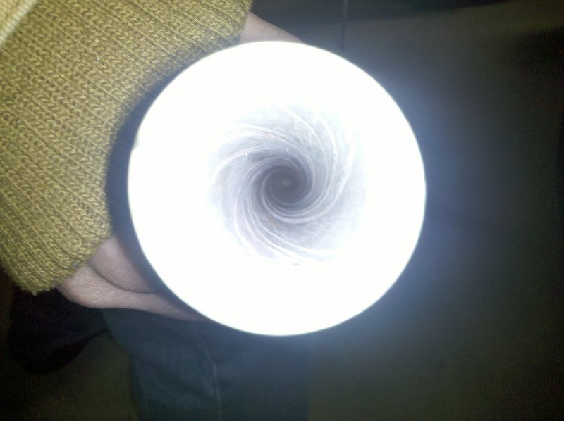

This pneumatic rifle uses a 2" piston valve actuated by a 1/4" ball valve as a firing mechanism. The piston itself is made from a 1.5" PVC cap filled with epoxy with the rubber sealing face sitting inside. Sidewalk chalk and wooden dowels are the primary ammo. The gun was finished in July of 2008 and has since been upgraded to add the scope, muzzle break, and rifled barrel.

  • *Rifled barrel

More rifled barrel
More rifled barrel
Rifled barrel
Rifled barrel

Very nice. How is the rifled barrel, have you compared it to a smooth barrel ?

Looks good. How good does the rifled barrel work?

In case anyone is curious, the barrel was rifled using a long wooden dowel with 4 wood screws in it. It was driven through the inside of the barrel with a hammer and twisted along the way down at a constant rate (3 passes were made). Similar techniques have already been described on the how-to forum.
We actually have a smoothbore barrel we were using with the gun to compare accuracy with the rifled one. In general, it was found that the rifled barrel had noticeably better accuracy as long as the projectile was snug and it's surface was something soft enough to be cut by the rifling. In the youtube video, we were using sidewalk chalk wrapped in tape to fit tightly. They at least seemed to fly fairly straight.
