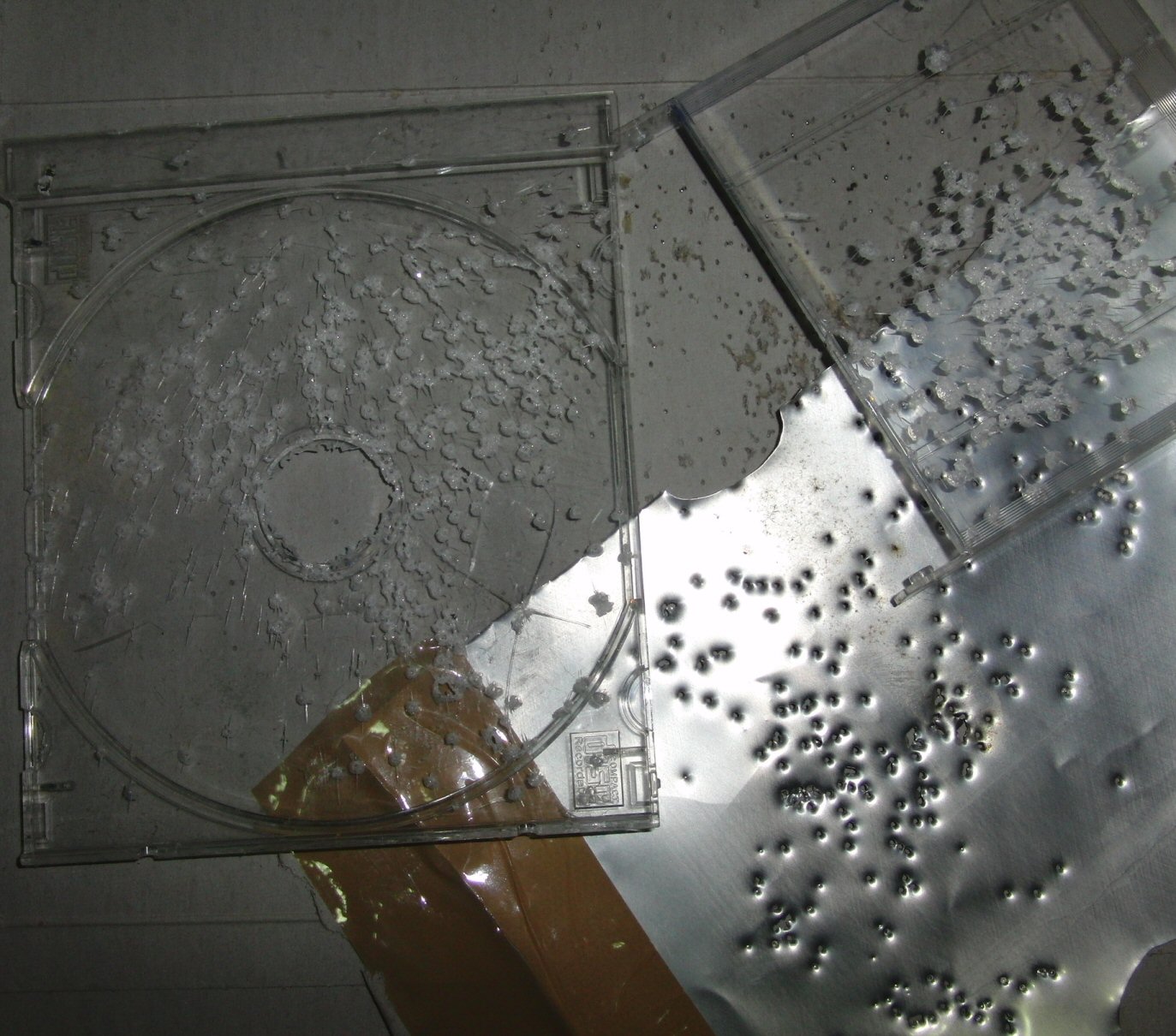

It's an opened up beer can, see below - I couldnt shoot the actual beercan because it would have made my location pretty obvious :D

Here's a nice macro view of the damage, as you can see some BBs are still embedded in the various media:
