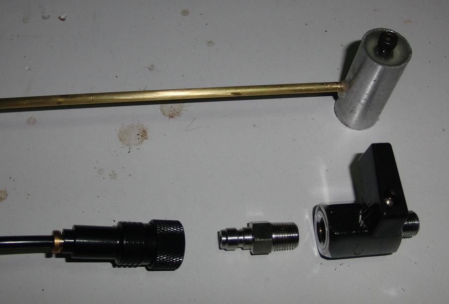

Update on this project, so far I have practically everything I need except the all important servos. The set I ordered over a month ago seems to have fallen through and should be refunded, in the meantime I ordered three ofthese with 75% more torque than my original order, let's hope they arrive soon.
Yesterday I received the paintball fill nipples which means I have all the parts to make the actual gun, I'll try and get started on it tonight.
