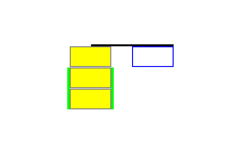

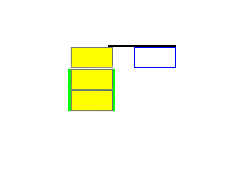

The question is: How far back should the barrel/bolt push the newly loaded shell? 100% of its length from the place where it entered the gun? 50% (overlap)? More than 50%?
Possibly important to note: In my design, there is a detent rod (black line in diagrams) connected to the barrel/bolt and it prevents the shell from being able to fall out of the ejection port due to the ejection mechanism (simple spring loaded ramp that will get pushed out of the way by the shell as long as the shell is secured by the detent rod, but will push the shell out once the detent rod separates from the shell). In the diagrams, it's not shown exactly where it would be, so I've attached another diagram for clarification.
Advantages of Overlap:
-Shorter overall length of gun
-Shorter cylinder stroke necessary
-Easier to increase the distance the barrel/bolt travels forward from the breech (allows more time for shells to enter gun and could reduce jams)
-Possibly allows for loading through the ejection port when reloading a whole magazine is inconvenient. (Being that the barrel/bolt does move forward from the breech, a removable detent pin would be needed when loading so that shells are not pushed too far forward, preventing them from reentering the magazine.
Disadvantages of Overlap:
-Harder to build (cutting breech and ejection ports will be a bit challenging. Attaching a magazine the way I planned to would have to be adjusted.)
-Possibility that fresh shells could fall out of the ejection port after loading because they are at least 50% exposed and not yet secured by detent rod.
-Slight complications to my detent rod setup.
Advantages of No Overlap:
-Easier to build.
-Detent rod easily incorporated.
-Guaranteed shell security (no exposure to ejection port except when secured by detent rod)
Disadvantages of No Overlap:
-Overall length increased.
-Necessary cylinder stroke increased.
-Potentially less distance that bolt/barrel can travel forward from the breech which could lead to incomplete loading and jams)
-Loading through ejection port almost impossible.

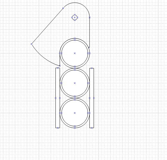

- The square is the body of the gun. Internal dimensions are .625". Diameter of shells and barrel/bolt are JUST slightly under .625" for a sliding fit. The detent rod slides in the corner between the square (body) and circle (shell).
For those who enjoy math, calculating the maximum possible diameter of the detent rod given those dimensions is a pretty fun algebra problem.

- 50% overlap

- No Overlap

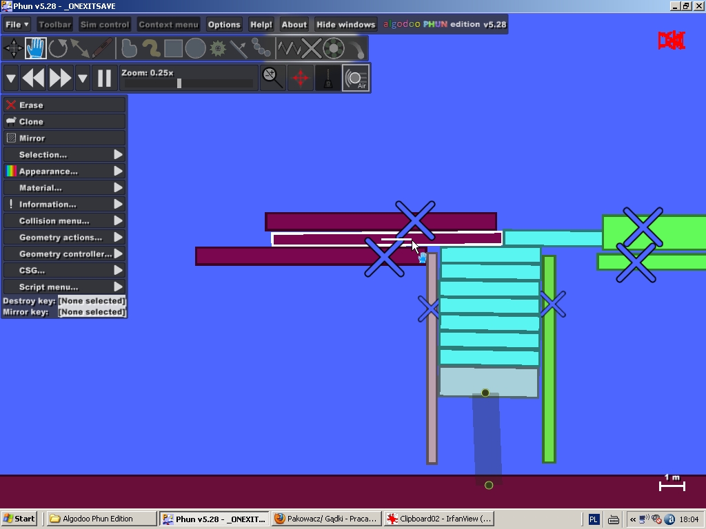

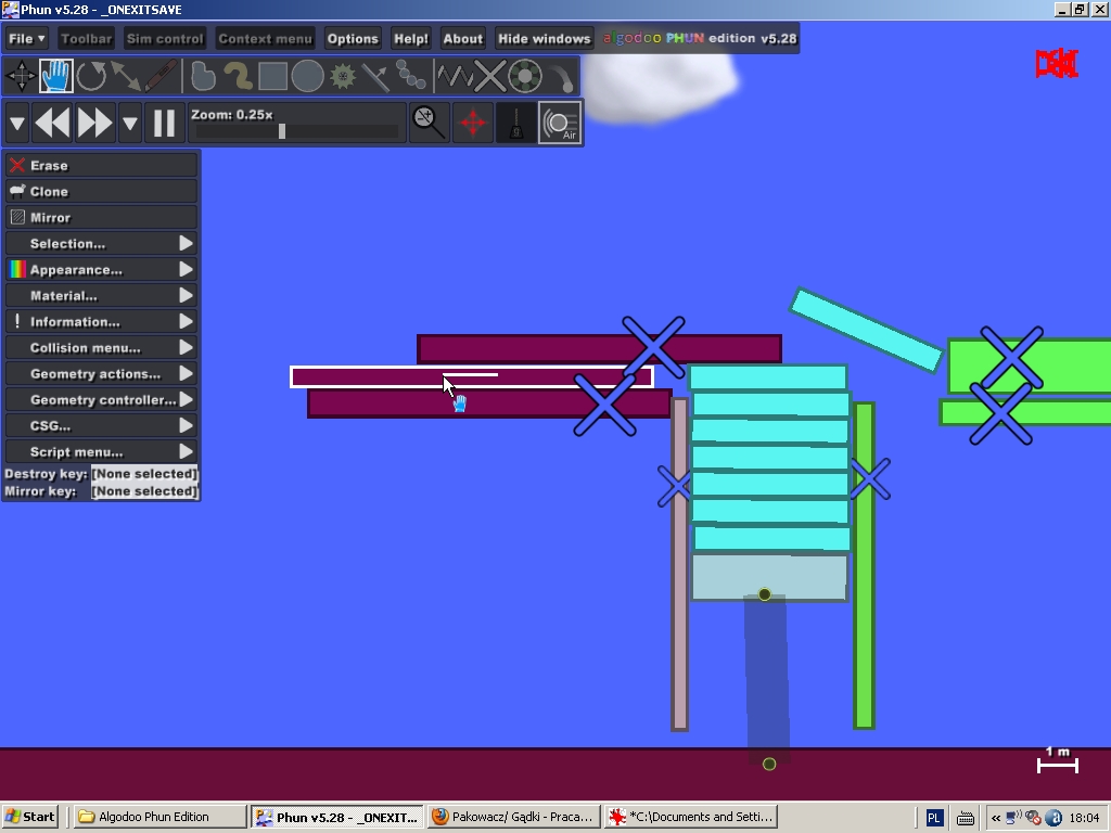

- POLAND_SPUD
- Posts: 5402
yeah you need overlap... well at least you would have ejecting cartridges... how it could work without overlap ?
I don't know why you need that detend rod ? just get two tubes: one (barrel) that fits in the other and cut ports in the outer one

- POLAND_SPUD
- Posts: 5402
well I don't think you need a ramp...
I presume that the barrel will be able to push the cartridge against the surface of the main valve fast enough... so once the gun fires and the barrel slides forward the cartridge will be ejected by the next round
