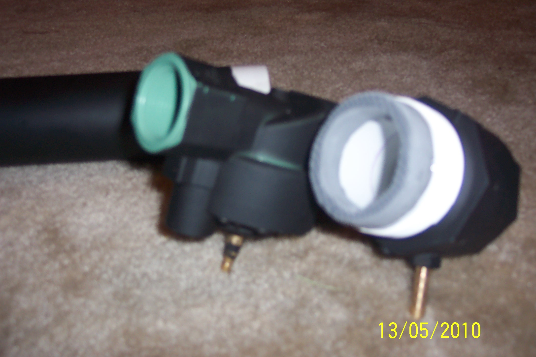

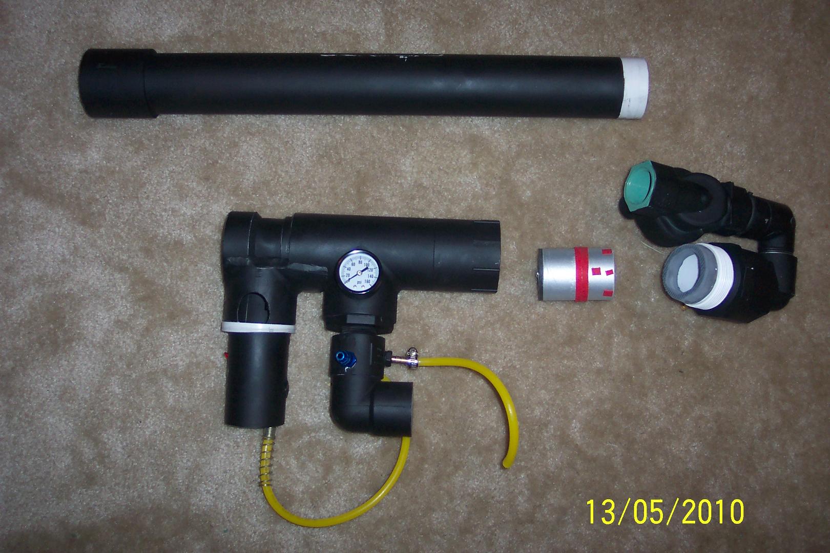

Well Yes Colonel clemsonguy1125,
It is a sprinkler valve. It turns out that the $11 dollar valve does a better job than the $15 valve. I could have taken a beter picture, but i figured if the looker knew what it was, they at least knew how it worked.
With the $11 valve, there is way less Humm/moan and more POP from the muzzel, I like it!!!!! I used the 1" version.

Interesting use of safeties. As good as a mechanical safety is, it is still not entirely foolproof. A busted hose or any other kind of leak can dump the pilot volume and trigger it, though you'd have to be pretty unlucky to have that happen. If you want an utterly foolproof safety, you can't go past a ballvalve right before the barrel. If it's closed, the gun won't fire, period.

Love the safety additions on your gun, I'll have to add one to my recently finished (sort of) piston valve rifle thingy, because with the rear seal on the piston a small bump on the pilot valve leaks enough air to trigger the pilot... not totally safe if you're not watching where you're swinging a 4'8" steel cannon holding 200+ psi. I love the dedication to safety, if you hold to that you could create some pretty designs that are actually safe and comfortable to carry around, without fear of bumping something and setting off a prepped spudgun. Rock on.

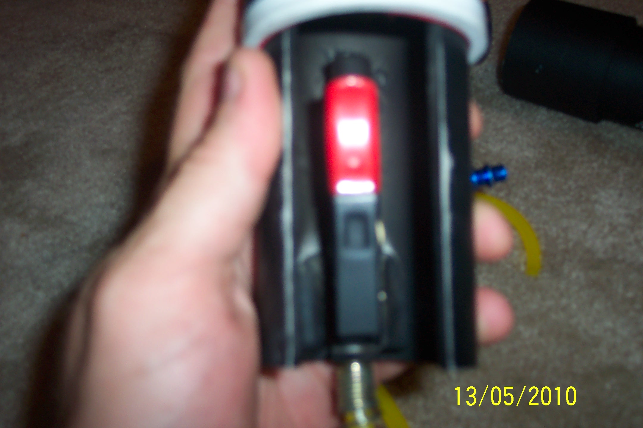

By Request,
Here are some close ups of the internals.
For the bumper, I went to the dollar store, and bought a set of flip-flops. I shaped it with a dremal tool, and used JB quick to attach it. 200+ shots zero failure.
The felt on the piston, allows it to slide, no lube, and provides a minor seal to actuate it back to the forward possition. Don't judge,,,, it works. 200+ shots with zero failures.
Everyone have fun, and keep it safe. Think about it before you do it.
