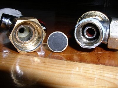

I have made a 1/2 QEV and it works great :D .
So I made a simple airgun from it :) .
The scope is not real but it helps a lot :o .
Pressure 100 to 200 psi .
I know it doesn't looks powerful but it is.
The 1/2 T is the QEV.
The piston's body is made of Bondo,with a rubber.

Nice, some people may hound you for the dead space, but it won't make much difference. Also, do oyu have a spring behind the piston? And do you pictures of the internals?

nice gun put more info, pressure, barrle length and dia
and if you can get a pic of the piston

I do have pics of that qev,the barrel is 60cm long with 6mm dia for shooting bbs.

Gun Freak wrote:Nice, some people may hound you for the dead space, but it won't make much difference. Also, do oyu have a spring behind the piston? And do you pictures of the internals?
I do have pics of the internals.
