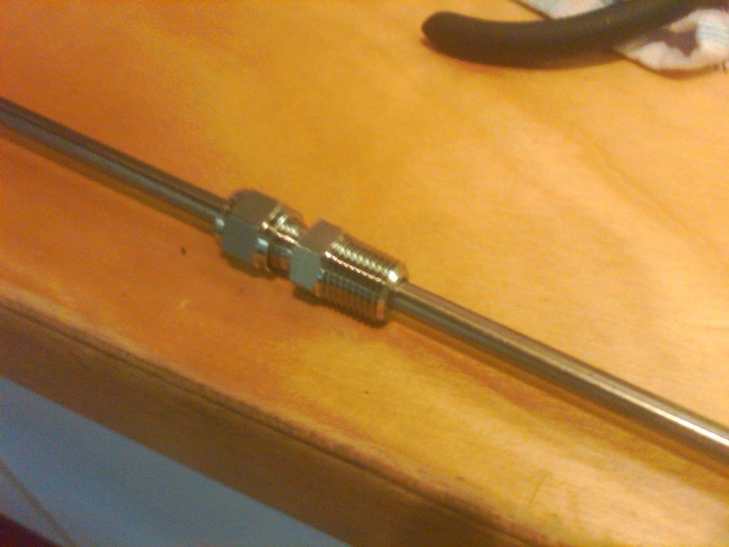

Updated spark strip info.
Here is the model, it consists of:
a 1/4NPT X 1/4"Tubing compression fitting, bored through
The inner rod is 3/32 316 welding filler rod,
surrounded by 5/32 PE tubing (perfect ID fit for the filler rod! couldn't resist),
Finally with 2.15" sections of 1/4" x .035" wall 316L tubing - spaced .16" between each to provide a spark gap.
The rear portion extends back far enough away to avoid creating a shorter gap for the spark strip to cheat from.
The overall in chamber length of the spark strip is appx. 12", with 6 spark gaps.
Fiddling with the HGDT has show us that 6 gaps will provide 300FPS gains over 1 gap, whether or not this is true... I can not yet verify. But if I could even get the 1 gap FPS results from the HGDT lets just say I'll be pretty happy!
The trickiest part will be sealing the rear most's 1/4" tubing gap between it's ID and the 5/32" OD which, if you do the math, provides for a .015" gap (before compression fitting crushes the 1/4" tubing lol). I was thinking some sort of RTV or silimar silicone would be well suited for the 2300*C flash at 8ms long, and 1000+PSI pressure spikes? Sorta sounds like a car engine lol... :roll:

Moonbogg

That render looks real as hell. Nice job. Multi spark gaps allow some peace of mind by making sure you get the most out of your combustion. Hybrid or not, I am all for multi spark if possible.

mobile chernobyl wrote: I was thinking some sort of RTV or silimar silicone would be well suited for the 2300*C flash at 8ms long, and 1000+PSI pressure spikes?
Epoxy should do that perfectly.
