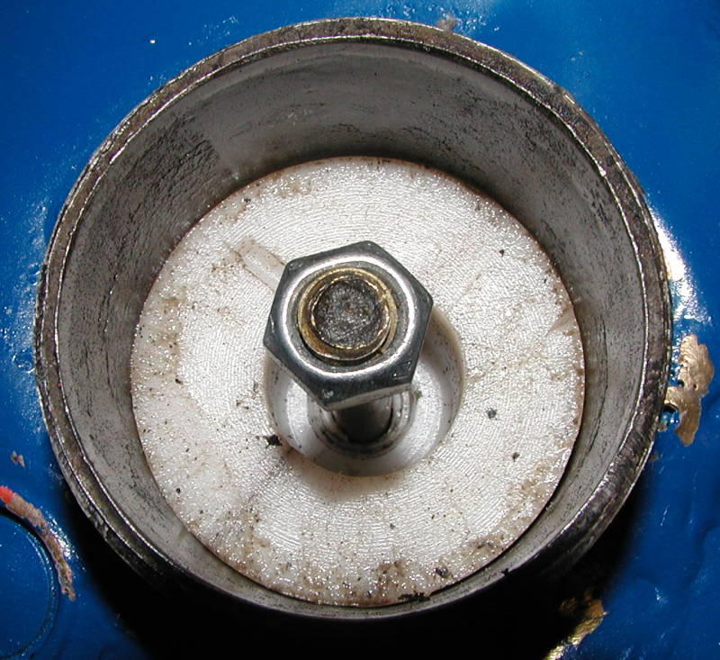

How can you make the barrel shorter than the chamber? They either have to be the same length or the barrel has to be longer. Think about it.
Ranger wrote: How can you make the barrel shorter than the chamber? They either have to be the same length or the barrel has to be longer. Think about it.
This barrel is most certainly shorter than the chamber. It is only longer when I screw on an extension.
[/img]
Chamber is over a foot long.  This barrel is threaded on the end for extensions.  It is 2 inches long.  This is a coaxial.

*If* we are talking about coaxials designed on the principles Here (the third animation) Then the chamber (the one that supplies air to the barrel, not the pilot area) cannot be longer than the barrel. In a *standard* coaxial, the barrel cannot be shorter than the chamber.
Technician, we are talking about coaxial piston valve cannons not your awesome QDV design.
By definition, that is a coaxial as the chamber and barrel are on the same axis.
In my golf ball bazooka the barrel is shorter than the chamber. The breech of the barrel does not reach the breech of the chamber. The muzzle is recessed and ends very shortly past the end of the chamber. It isn't much shorter, but it is shorter.

Muzzle of the GB coaxial.
