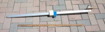

This is a 48" Aluminum clamp with stops every inch.
The fork is fixed and the Theraband silver tubing will be a single piece coming from underneath and over the pulleys.
The trigger mechanism will be attached to the sliding block.
A foot stirrup may be added to the fork and a pair of draw handles to the trigger to enable a 2 handed draw.
BTW The 48" clamp is on sale for $8.99 at Harbor Freight.
(I removed the fixed clamp end with the screw mechanism)

Stu, I hope that the locking is strong enough for Thera Tube Silver. Be careful, should something break then the rod will be on its way in your direction.
Also stock up on heavy lead balls. The Thera Tube Silver needs that to maximize power if you use it as a direct energy source without any transmission or air compressor.
It is not very fast on the retraction, so lightweight bullets won't do any good. Heavy stuff works well, though.
