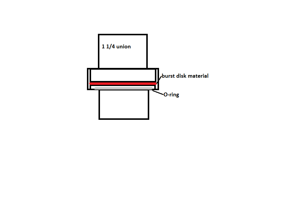

i am using a 1 1/4" sch 80 union for my burst disk but it leaks like a sive. ive noticed that the burst disks (pieces of pop can and cardboard) wrinkle as a result of the center bulging. then i switched to duct tape which does not wrinkle but it still leaks through the union. other than wrapping the treads in teflon tape i have no other solution.

Try o-ring -> burst disk -> washer.
The 1 1/4 union probably damages the burst disk when you screw it on.

Wich side of the union is connected to the chamber?
The O-ring should be on the chamber side but you probably understand that.

also Spudfarm the non threaded side is connected to the chamber

I grinded down one side of the union to help with it sealing.
I use a double gasket to help add thickness so the union can be tightened more without running out of threads. The gaskets go on the flat side of the union and the burst disk on the threaded side.

With those cheap unions bought at hardware stores, sealing issues do pop up occasionally. My best solution to the problem was to face the tapered part sticking out so that it's simply a flat surface, and then to use butyl rubber gaskets on both sides of the disk to seal and prevent tearing. Got me a nearly leak-proof seal at 150psi. Chuck a pipe nipple in the lathe then thread the union onto it to get a good centered grip.
If you don't have a lathe, I did have some success doing it *very* carefully on a bench grinder (that's what I used for SCTBDC, and it didn't leak enough to be worrisome at 500 psi).
If you're not using a triggered burst disk (and thus not trying to get a seal on both sides), facing the tapered part isn't really necessary, but it's still preferable to use gaskets on both sides of the disk.

i am VERY limited to tools and supplies (drill, hack saw, 1 file, chop saw for wood/pvc and some of my dads tools) but i should be able to get a hold of some gaskets after i move in about 1 week or 2

I've never bought gaskets for unions. Cutting them from old car tire inner tubes works just fine for any union I've used.
