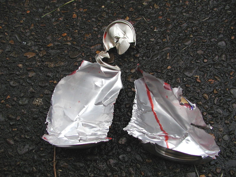

nice job on the crushing but the can split still needs some work, im surpirezed you guys can get a better slice than me since i was using a blunt edge when you guys use much sharper objects...
once i get my piston fixed ill do some more can crush shoots too
Load it so the bottom of the can hits first. Part of the split can is due to the can getting a shot of compressed air inside the can on launch.
I can tell from the cement pattern on the rim that it was launched top first.
I never tried any low pressure shots. I'll have to try some to compare notes.
Nice wrap around on the hoe. Nice shot.

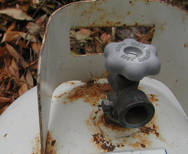

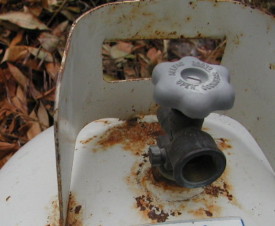

My target was the handle of this propane tank.  I did not use a sharp edge for those shots.  The mystery splat was shot at the side of the tank.

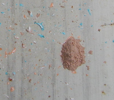

Using the 1 inch barrel, I shot a mystery item at my target.  Anyone care to guess what it was?

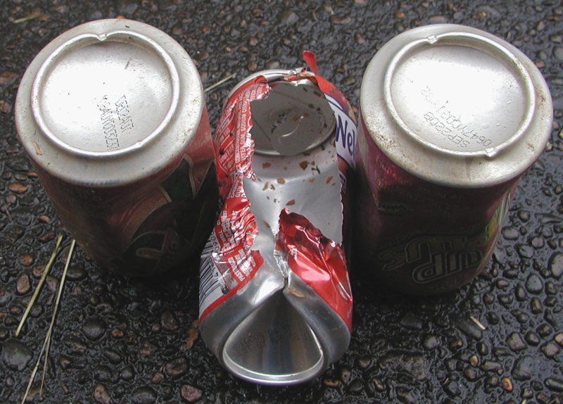

3 cans.  The two on the outside were launched from the 7 foot barrel.  I'm not impressed.  The middle can was launched from the 3 foot barrel.  Much better except my aim was too high.
