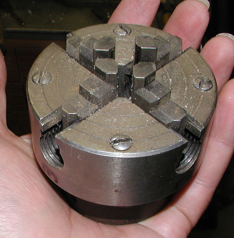

Self centering 3 jaw chuck is the workhorse. It is the late equivelant of a Jacobs chuck on your electric drill. When is the last time you fiddled with an electric drill to center the bit? Most round stock work is best in the 3 jaw chuck for that reason. It is fast. I rarely use the 4 jaw chuck, but for the times I use it, nothing can beat it.
If you make model steam engines, or do other machining like that, you will quickly find the value as you cut the cylinder and valve in a single casting.
I consider a 4 jaw chuck a lathe essential and would be lost without one.
It is like having a socket set without a 1/2 inch socket. (10mm for you metric guys) You can do lots with the set, but it is missing an essential function.
Note the bevel on each tooth in the photo below. This will hold bar stock, rectangular castings, etc just fine.
My dad's 4 jaw chuck.  Each tooth has a setscrew.
