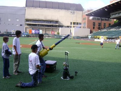

An alternative to a dive tank is a high pressure Nitrogen tank with a regulator. The school that built a QDV competition shirt cannon uses one as most sports arenas won't permit extension cords on the floor for the shirt cannon compressor.
Below is a photo of their set-up. The regulator is set to 100-150 PSI for quick fills, but they only fill to about 35 PSI using a gauge, as that is all that is needed.
The Arlington team launches some shirts into the upper deck at PGE park in Portland Oregon with Nitrogen.  They put one shirt on the roof.

The competition rules for the above had a 100 PSI limit. With the restriction, we won the competition. With no restriction, higher pressure and a smaller chamber makes sense. Even with the 100 PSI limit, we would have done fine with a chamber 1/4 that size. We were able to reach our target of the back row of the 300 section on only 35 PSI.
At 100 PSI my small chamber launcher with a 1 inch valve tosses shirts 200 feet.
