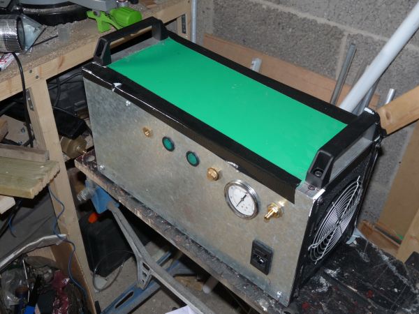

compressor nearly finished, need to replace the plastic top with some more metal sheet and she's done
damn... that looks great :shock:
