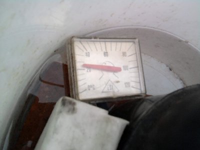

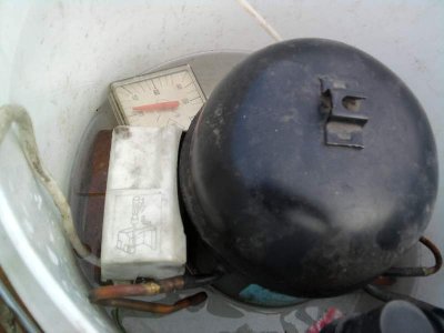

EDIT
Yeap... It gets waay too hot... especially whne running at 400 psi for an hour or so
ohh BTW my face just got a few ricochets :? damn that was stupid
I filled the bucket with a couple of litres of water...
Doesn't look very safe...
