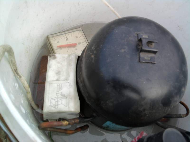

I concluded that air cooling just isn't the right solution... adding some fins/radiators might help a bit but I want to build the ultimate cooling system
I think that liquid cooled system would be the best idea. The idea is simple: get a bucket put the compressor in it and fill it with liquid. Oil would be ideal as it isn't conductive. However it is also fairly expensive and I am going to need about 15 litres of it
However, because the compressors are perfectly sealed I concluded that I might as well use tap water... The only problem is to seal perfectly the 3 pin connector but I think I might be able to do that
so... do you have any thoughts, ideas, opinions etc. ?
water or oil cooling??

well I concluded that an 80W fan is an overkill... and if it can't keep the damn thing cold on hotter days or when I use it for more than 2 hours then it might be a good idea to try something else
AFAIK vegetable oil deteriorates with time... I am leanign towards using water as it has higher heat capacity than oil... I might as well use 50 L or morevegetable oil

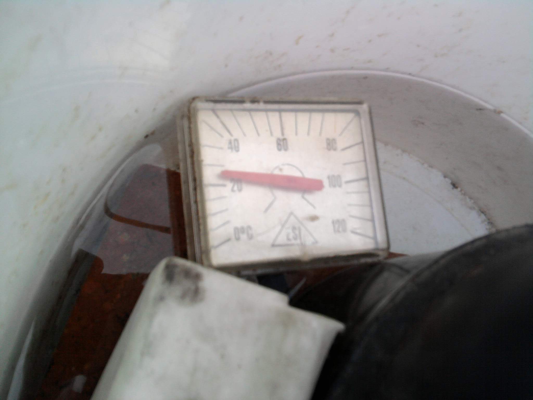

Remember that just dropping the compressor into a bucket of water will keep the thing at or below the BP of water. That may or may not be cool enough for you.
If the temperature of the compressor is more than a few degrees below the BP of water than all the water really does is increase the heat capacity of the system, it does fairly little to the ability of the system to dissipate heat. In other words, it'll take longer to get to say 180F if the compressor is in water but it will eventually get there. You need some way to actively room heat from the system, like a radiator.
If cooling is really needed, and assuming you don't want to use a second reefer to cool the first compressor (
), and water is ok...
wrap the compressor in a towel, dribble water onto the towel, blow across the setup with a small fan (like 4" computer case fan). Basically a swamp chiller. They are generally very effective and use minimal power, but do require a slow stream of running water.
Edit: You might be able to skip the fan and the running water by wrapping the compressor in cloth then setting it into an inch or so deep pan of water. Capillary action will draw water up into the cloth and simple air convection may give enough evaporation of the water for effective cooling.

well it isn't that bad but what if I add another compressor ?It keeps my compressor running a few degrees above ambient for as long as I can be bothered to run it for
hmm I've got to test something then I'll report back
EDIT
Yeap... It gets waay too hot... especially whne running at 400 psi for an hour or so
