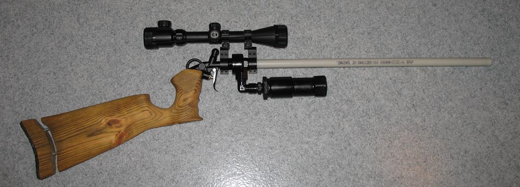

Info
1/2" QEV.
Pilot valve: modified blowgun (original didn`t take pressure over ~10 bar, and too low airflow).
.50" barrel, 57cm long (22 inch).
Wooden stock with adjustable length.
Scope is a cheap 3~9X40 GD from Dealextreme.

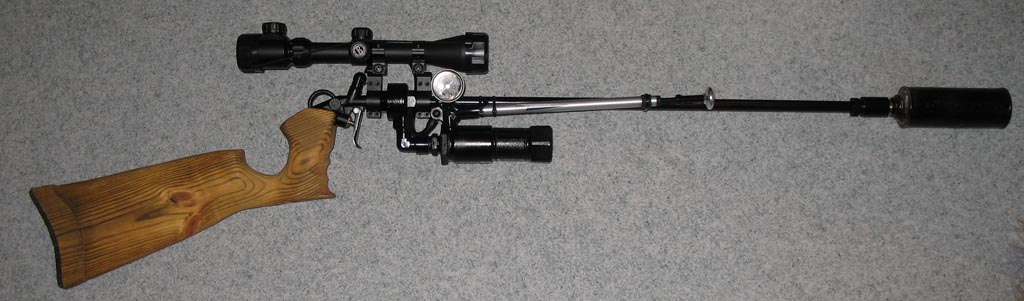

Pump: fork-pump that can handle 450psi/31bar.
Operating pressure: I actually dont know myself because the manometer on the fork-pump is somewhat... bad. When my compressor shows 9 bar, this show about 5 bar
It is probably calibrated to show accurate measurements @ 30 bar.
The gun is easily taken apart without tools for transportation etc.

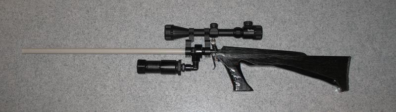

Next project will be a semi-auto bullpup design with a 1/2" T-valve actuated by a electromagnet (coil + magnetic piston). But it will probably take a while to build, if I ever complete it... Well, that is another story.
