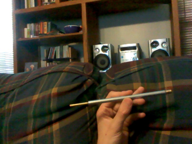

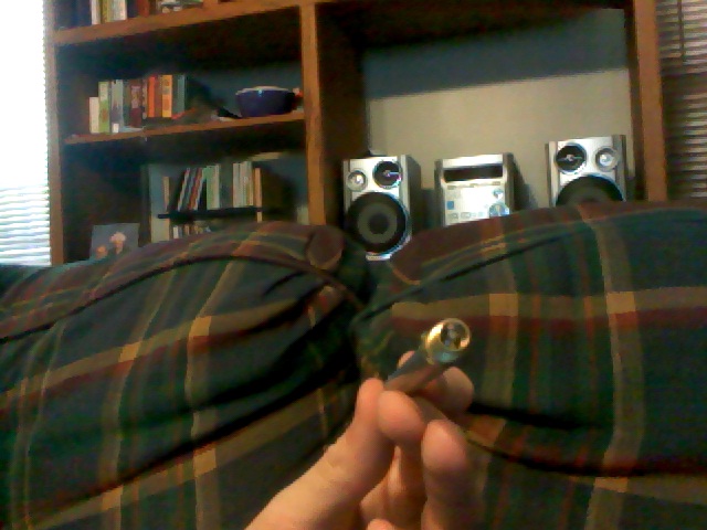

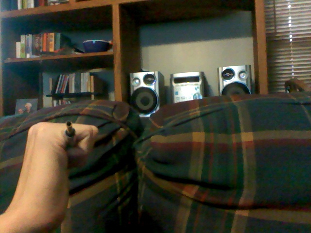

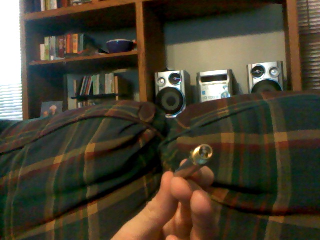

After seeing the multitude of pen guns posted in the last few weeks I decided to try building one. Right now all testing is done at 80-100PSI until I get my shock pump, then Ill up the pressure. The video below is a 80 PSI shot with a small nail at a Pepsi can.
Chamber-7.14mm Brakeline
Fill-Schrader
Pilot-Schrader
Piston-a piece of a rubber spongebob key chain
Power-Shot a toothpick across the room at 150 PSI
Fill-Schrader
Pilot-Schrader

Looks good but I would've liked to see the piston before it went in. Awaiting damage...

Its similair to JSRs. just a piece of rubber punched out with a piece of the chamber, ill test it later, if it doesnt work, ill toss it into my bucket of failed minis

Did you get a threaded schrader or is it a normal one just epoxied in?

I bought a normal one, put it i my drill and held a file to it until all the rubber had be shaved off, than roughed it up a little so the epoxy would bond to it

Ok cool, how long has the epoxy been drying, and when you gonna shoot it?

Later today, its supposed to cure for 30 minutes but im given it 3 hrs to be safe
Edit-Tested it, Shot a tooth pick Wrapped in tape across the room, Im having issues filling it and disconnection it from the pump without piloting it

No problem spud blaster, thanks for the tip, BTW I added a picture of the gun with its grip, and eraser cap

Thanks, Im planning on ordering one later this week, whats some good amo youve found, little nails work well but I cant find anything else, the barrels 5/32 brass

Either nails wrapped in tape, or at higher pressures steel ball bearings of the appropriate diameter.

Ok, i guess for now im stuck with nails, once I get the shocky Ill see what it can do at 300 PSI, thats the max I feel safe with this gun

Looks very nice clemonsguy, how did you end up spacing the barrel from the chamber?
