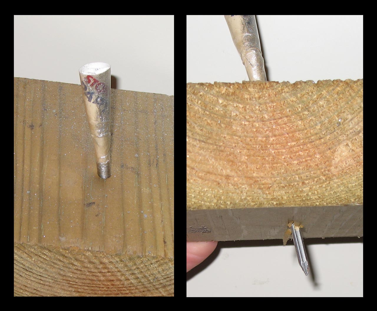

Almost finished. Did this stock in a hurry so the finish is not nearlytheBOOM wrote:Is that new stock finished??
Also, what are you using as a chamber??
as good as the other one. Im painting it now, pics will come soon
The chamber is made of 1-1/4" "metal-pipe-fittings" (dont know the correct terms in english
Swosh, the gun is quite powerful
Testshot @ 4.5cm (1.77") wood.
Btw, any tip on a good (and maybe cheap?) .50 ammo? Tested .47" wooden balls, but that was a catastrophe... .50" airgun lead
pellets would be nice, but I can only find them in america = too high shipping costs to europa.
