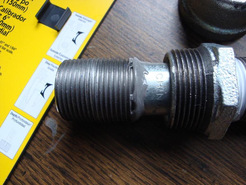

UPDATE 8/8-- almost complete with piston construction. Just have to JBWeld everything together and cut shaft down. That should be done tomorrow. The flat rubber seals seem like they should work, I have them trimmed so I can push the piston in and out with a pretty fair amount of force, we'll see what some lithium grease can do as well. Hopefully they seal well otherwise I'll have to start a new piston.
The other picture is of the sealing face. It's a little complicated. There's a 1.25"x1" bushing, but I couldnt thread a 1" nipple into the back. So I pushed a 3/4" nipple into a 1" nipple, threaded the 1" into the bushing the normal way, and JBWelded a 1" nipple on the portruding end. Its complex, but the ease of sliding the 3/4" into the 1" allowed for really good straightness.
