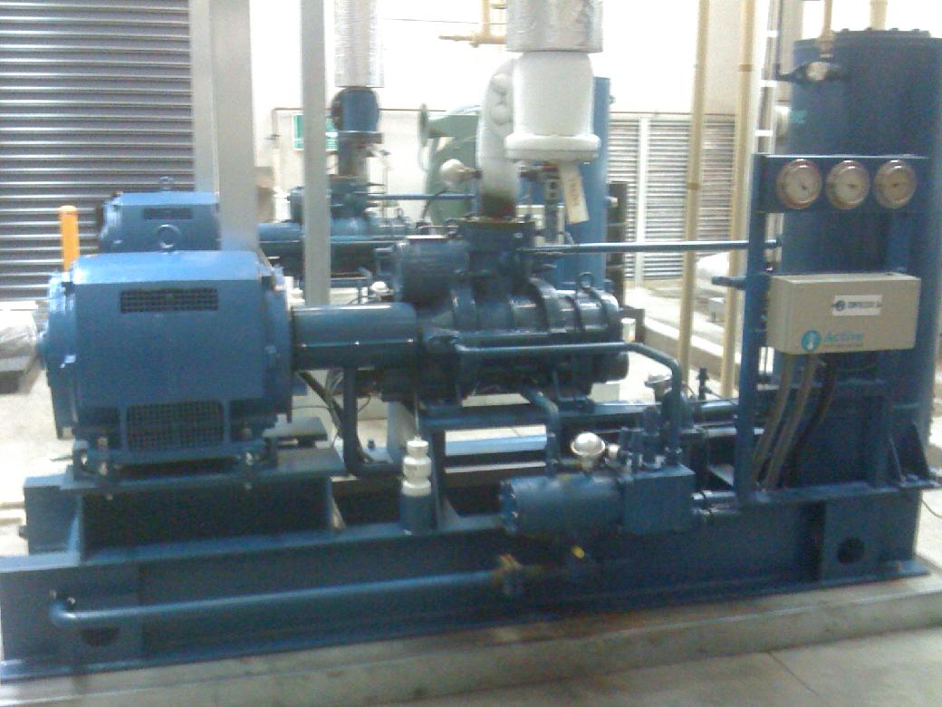

At work to day i was taking a part one of the two giant frigde compressor we have, so took some pics to show yall idont know how much pressure it runs at or its max.

you sure can have one if you wanna sell your house, the piston and seal we replaced was $1700

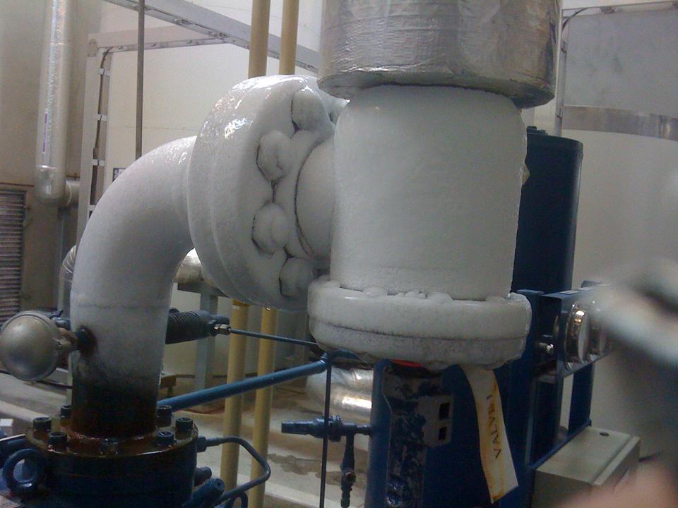

If you worked refrigeration, you would know the output of the compressor is the HOT side. That frosty line is the compressor inlet. The frozen object is most likely the suction throttle valve. It is used to control the evaporator pressure to prevent freezing the water on the air coil or heat exchanger on a chilled water system. This is why the area above it is not frozen. The pressure drop on the valve is why the inlet line is frosted.
It is basically a vacuum pressure regulator to maintain the evaporator pressure and thus temperature of the boiling refrigerant.
If you check the rating plate, you will find this unit is in the 100 ton size.
1 ton of refrigeration is 12,000 BTU.

im not a refrigerator mechanic i just work there every friday for a school thing, most of the time just take stuff apart and clean them, figure it would cool on the output, always learning new things, its funny the ice isn't really cold like the one out of my freezer. your hand wouldn't go numb if you held it there.

the refridgerent becomes cold when given a chance to expand
hence the low pressure side is frozen
