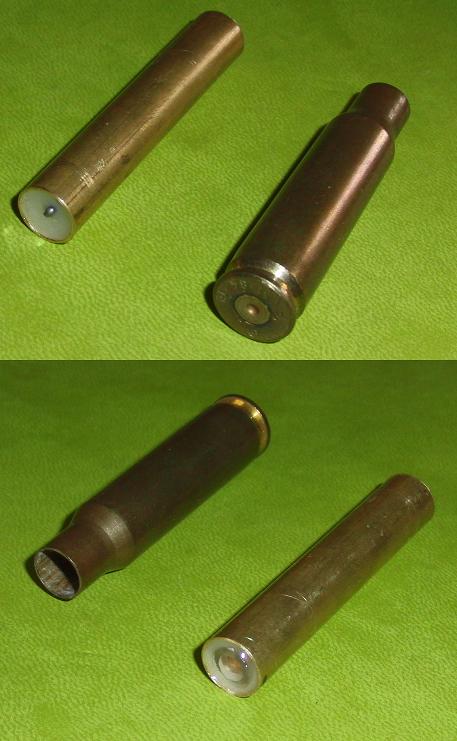

I've decided to go with a single seal, but curing with a BB already stuck in it. The problem with the first cartridge was that the outer diameter of the seal was identical to the inner diameter of the body, so there wasn't any room for expansion. Should be good for a 7-8x mix, we'll see.
edit: added some pics compared to a 7.62 NATO cartridge, note that I used Araldite, and also you can see the BB in the mouth of the cartridge.

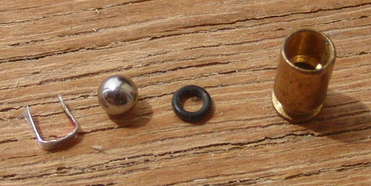

edit: while it would be a plus, I've come to the conclusion that trying to use the projectile seal for filling is not practical. Using some simple parts I managed to make a small check valve that works very well, using some parts from a cigarette lighter valve. Making my n<sup>th</sup> prototype as we speak :)

Unfortunately, you do lose simplicity, but it's still simple enough to make 15-20 of them which is all I will need really.

The valve you are thinking about using now can probably be made easier and cheaper by using .22 cartriges with a hole drilled through the back. Just dent it at the "front" to stop the ball bearing from popping into the chamber during fueling.
You won't be asked why you buy so many lighters atleast :P
