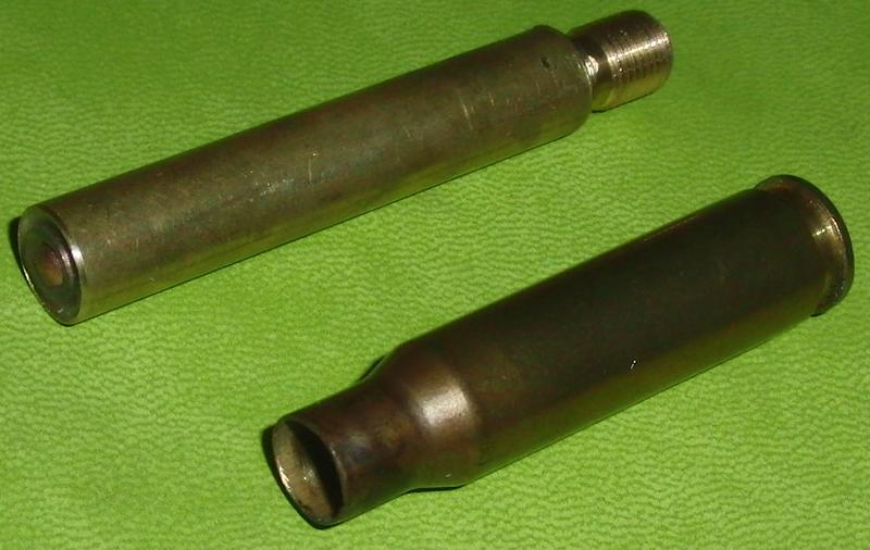

Right now I just want the bloody thing to work, adding simplicity can come later
I have the prototype cartridge on my desk at the moment and I'm *really* tempted to try it out but the epoxy still hasn't hardened fully and I know better than to take my chances
edit: tested it for pressure retention, seems to be ok

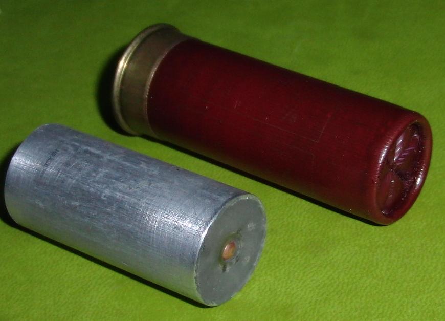

here it is compared to a 12 bore shell, hybrid testing tomorrow.

If only! The damn thing isn't holding pressure, gah this is so bloody frustrating!

I'm also surprised why no one didn't ask "It seems you have unfired 12 bore cartridges, what the hell are you playing about with hybrid cartridges for?"
that did cross my mind when i first saw the picture but i thought it wasn't that constructive to this thread but now you mention it, what the hell are you doing then?jackssmirkingrevenge wrote: I'm also surprised why no one didn't ask "It seems you have unfired 12 bore cartridges, what the hell are you playing about with hybrid cartridges for?"
... quite the contraryno one didn't ask "It seems you have unfired 12 bore cartridges, what the hell are you playing about with hybrid cartridges for?"
So that was the lighter/ball bearing check valve combo ?
Where was the leak from ?

I'm doing it because I can!ilovefire wrote:now you mention it, what the hell are you doing then?

It's leaking from the check valve, for some reason. Didn't fire before. Or maybe it did fire without popping the projectile, and the heat from combustion screwed up the seal, fricked if I know.

In the meantime, I calculated that the "dead volume" in my shock pump is about double the volume of my original cartridge, which assuming backflow of fuel into the pump would more than account for an insufficiently concentrated mixture.

- Posts: 26220
- Been thanked: 352 times
Since the hot wire ignition allows me higher mixes, I've gone for a smaller cartridge. I tested the wire and it glowed red hot immediately so I'm confident that at least that is ok. Should it work I'll do both HS and HD video. Tonight promises to be a heavy one though so results might take a while
