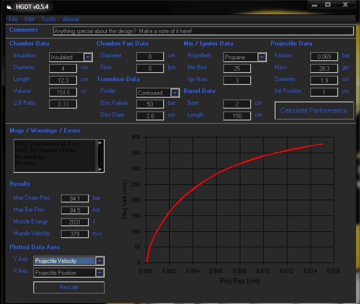

the trouble is that I don't plan on firing this under 25X, only 25X and up to a max of 50X and HGDT gives me a prediction of 84 bar for a max chamber pressure (1 218 psi) so perhaps it would be a safer idea for me to first make a burst disc cannon out of this chamber and skip the cast aluminum on this for a while you guys made me doubt my aluminum casting :?

Here is my version, using the same program (my mistake, 600 psi).
HGDT info in mostly the same configuration, just a larger barrel and chamber opens right about the 25x pressure.
