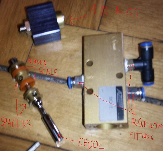

Also, an air piloted 3 way can work as a sort of regulator. Have a look at this
if you want to switch it you've got to send air signal to the pilot port. Of course, the air pilot port can be hooked up to almost anything.
If in normal position propane can flow through the valve to the chamber and from there to the air pilot port then you can use it to automatically cut off propane as soon as the right pressure is reached.
If you want to use it with propane then you probably need and air amplifier, which is basically just an air pilot attached to the 3way, but larger than the one you can see above. The larger the diameter the lower pressure you can use to switch the valve
Ohh I found a pic of a valve with it Image
They come in different sizes and shapes but they are all just air piloted 3 way valves

Okay I understand little bits of what you're trying to explain to me, but since I have no understanding of what's inside that "air piloted 3 way."
Are you saying you could put a pop-off onto one of the ports pilot the valve and cut the flow?
I think what I posted could be considered an "air piloted valve." I'm adding an explanation of how it's supposed to work for clarification.
Inside there is a piston. When you pressurise the thing the piston moves and switches the valve - that's all. It's like a miniature air cylinder - it converts pressure to motion.
yeah, it's that simple.
