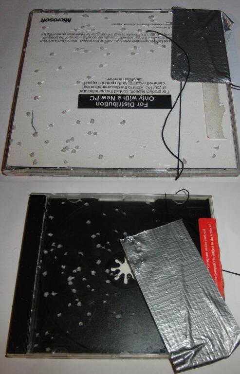

Power is what can be expected of a 1mm BBMG, a single BB will not penetrate a CD, but will happily chew up cardboard smileys:

As you can see it's pretty ghetto, but works quite well :) the high velocity flow causes the POI to shift upwards but that can be compensated for. There's also a pretty wide spread of shot, almost the size of an A4 paper at 10 feet, a "shotgun" effect which should increase hit probability.

target closeup showing the spread of shot after two bursts
