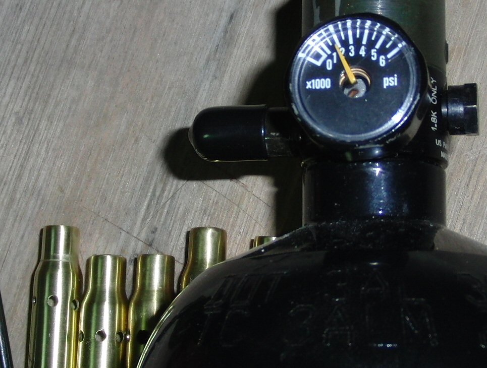

I suppose it sounds worse than it actually is (remember that air flowing down the remote line makes noise even through a completely sealed connection), I have 3 more cartridges curing so in a couple of hours I'll be able to do before and after measurements of paintball tank pressure to calculate air usage for a 5 round burst.

As to air consumption, compare the gauge (on a 48 cubic inch tank regged down to 800 psi) before and after firing 5 rounds:
