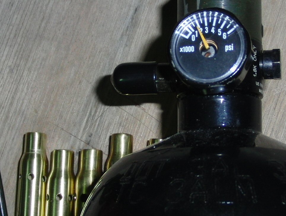

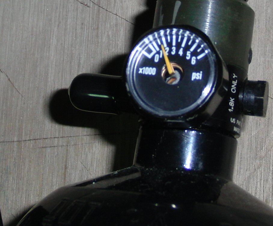

As to air consumption, compare the gauge (on a 48 cubic inch tank regged down to 800 psi) before and after firing 5 rounds:
