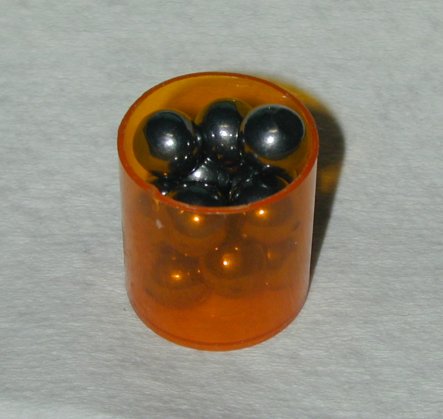

If I do, one of the shots will be with the following:

Here are the first two rounds that I tried in the one inch barrel.
They both use pill bottles as sabots.
The one on the left is a single steel shot 'stuck' to the bottom of the sabot, using candle wax.
The one on the right is the buckshot style. With paper towel wadded into the pill bottle on top of the shot.
Here is the "buckshot" damage.
