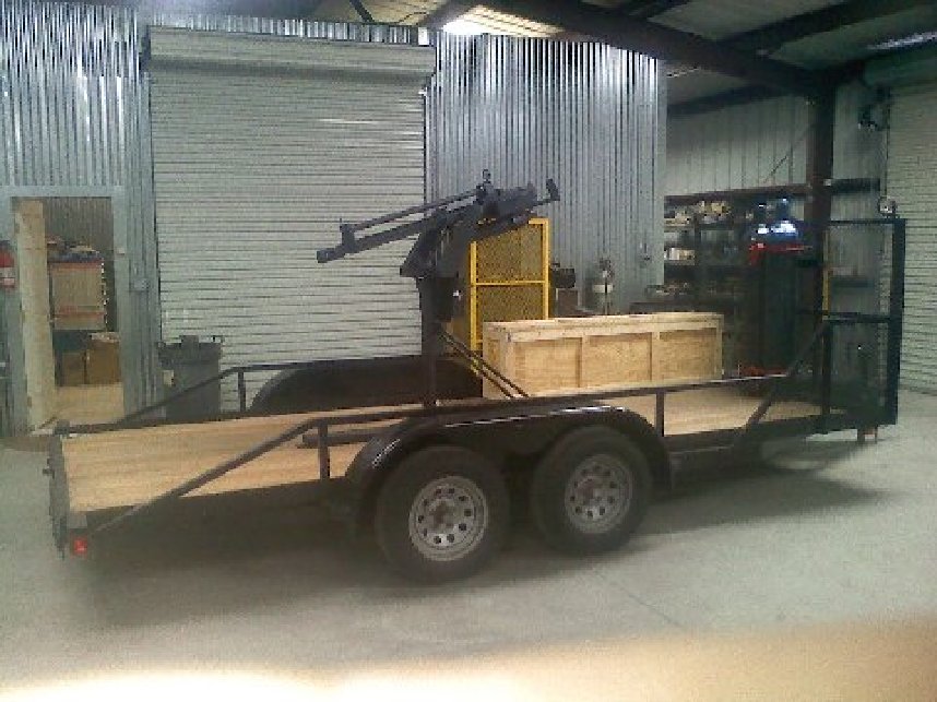

So here are the final specifications:
- Roughly 20 gallon chamber (75.71 liters or 4620 cubic inches)
- 20 foot long 4" bore barrel (about 3016 cubic inches - C:B ratio is 1.53:1)
- Two parallel 3" Toro P-220 Irrigation valves (14.13 square inches of porting)
- Breech Loaded
- Trailer mounted (old boat trailer)
- Pneumatic barrel elevation
- On board compressor
- On board Generator
Any thoughts/concerns before I start welding?

I'm not sure what your finished setup will look like, but just don't let the recoil flex the valves... it should be absorbed by the trailer directly.
Also, for this type of stuff, it's a good idea to go over your welding and assembly operations mentally several times;
more than once I've gotten in a hurry and welded on something that got in the way of parts I had planned to attach later.

Those are some pretty serious specifications, it's going to be one heck of a finished launcher.
I think the dual valves are slightly overkill, in the sense that the difference in performance will probably not be that noticable vs a single valve, but if you have them, go for it

Due to the issues of transonic flow in the valves (how air turns the corners at high speed) I have to disagree on the performance of one vs 2 valves. 2 valves will still have a fairly high loss even though the port area of the combined valves is slightly larger in area than the barrel. The dual valves will have a considerable pressure drop across them limiting flow to about 1/2 that of a burst disk with no bends between the valve and barrel.

Any thought of using a muzzle brake? With 12.56 in^2 of barrel cross section, even low firing pressure can create a significant secondary recoil.

Will the trailer be free to move? That would certainly help with avoiding damage to the launcher. Unless it's on the edge of a cliff.
Mounting the launcher itself on a sliding mount shouldn't be too big a deal either, add a few scrap parts from a motorbike suspension system and you're sailing.

I note from your first post you want computer controlled elevation and traverse, in which case a moving mount (trailer in this case) would be a hindrance to accuracy and repeatability.

I believe D_Hall's method of fighting recoil on Vera was to make it one hell of a solid cannon. The heavier the cannon, the easier the recoil forces will be received. Just mount everything solidly and put wheels on it if you're still concerned.

The trailer will most likely be hooked up to my truck, but I guess at this point I can change that too.
I don't think a sliding mount would be feasible, unfortunately, as there will be several points of attachment to the trailer.
What are the chances that the barrel (or the tee) would crack (it's PVC but will be supported) if fired from a stiff mount?

For 4 inch, may I recommend ABS instead for the barrel? It is much less fragile. I have tested 4 inch cellular core drain pipe with 100 PSI pressure in it. All it will need is a little support to prevent barrel whip.
