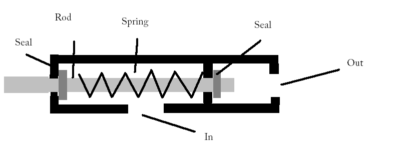

I looked at the valve again, in order to fire, one has to press DOWN on it, meaning its at a 90 degree angle, what I need is a 180 degree valve, where I push it left and it fires right, or I push it right and it fires left. This only works if I push it down, and it'll fire left/right
http://www.clippard.com/store/byo_contr ... valves.asp
Can someone help me BUILD one? 'Cause I have no idea how I'm supposed to do it. Basically, its a straight (180 degrees) valve with a spring return and a stem. When its left as is, pressure is vented via exhaust. When spring is pressed down, air. Ex:Spring on left, exhaust on the right. When spring is left as is, air is vented out of a hole to the atmosphere, when spring is pressed, the air is vented out to the exhaust on the right. I noticed how you can't link the builds, so just tel me the build please, you have my thanks

The design you posted only moves the back part, I rather it moves the back part of the cylinder. And as for the valve MJVO-3, I think I mis-interpreted it, just as a run down. air source though threaded part( top of the pic) the metal thing sticking out is the spring and and other 1/8 NPT port is for the the barrel? What's the little exhaust hole for?
At least, thats how I want it, on a second look, the threaded part is the out, which means if the spring is pushed, air flows from chamber to barrel straight forward, I want the flow to be at a 90 degree angle

The Clippard valve is a 3 way valve... your diagram is saying you only need a 2 way. I think the MJV-2 is the valve you need.
nadjatee1996
Posts: 185
Joined: Mon Jan 03, 2011 7:20 pm
What's the difference again?Also, same problem here, look at my diagram again, the in and out are reversed

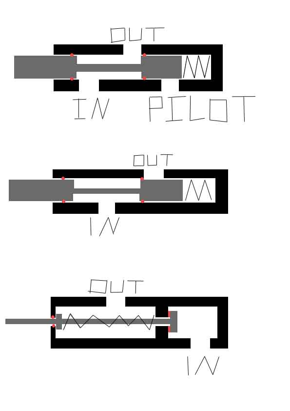

ilovefire
Posts: 511
if you were using a 3-way valve then it would be to fill then pilot a piston valve, but if you are use the valve as the main valve then you would only need the 2-way, a 3-way to fill then pilot a piston valve would be much better performance than using a 2-way because opening time would be much less and flow would be much better

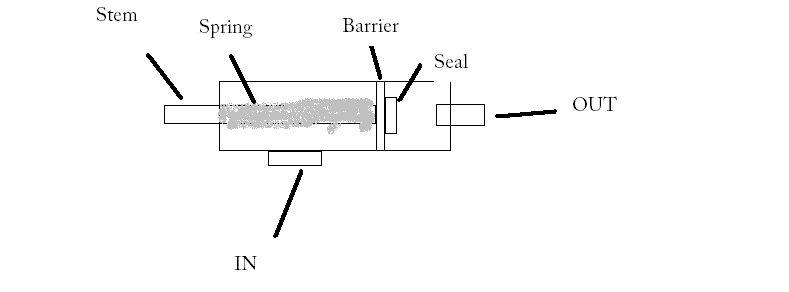

I'm gonna seem like a kid..but..IN YO FACE(I build a semi working protype, it's not working because the corners I cut out of wood was not perfect, but I'll be making one out of 0.04 aluminum once I order it
I forgot to add it, but theres a seal on the left side of the spring too
SPRING, WOOTWOOT.PNG (9.71 KiB) Viewed 7333 times

You may not have very much artistic talent, but if you maybe spent an extra ten minutes or so on you're diagrams, this whole thread might just make a whole lot more sense. In turn, this will allow other members to get what you are saying, making it easier for us to help you.
nadjatee1996
Posts: 185
Yea, my diagrams look a lot better on paper, but my scanners busted, sorry guys
ilovefire
Posts: 511
nadjatee1996 wrote:There's no age restriction on this forum last I checked o.o
no there is not, i am only 17 i was just wondering so i know what age i am directing help to, i dont care if your 10 or 50 i just thought it might help to know
nadjatee1996 wrote:(I build a semi working protype, it's not working because the corners I cut out of wood was not perfect, but I'll be making one out of 0.04 aluminum once I order it
how can it be semi working if it dosent work? anyways i looked at your diagram and from what i can tell it will automatically open when you put pressure in it
ok this took me only 15mins to do, top is a 3-valve, in the middle is a 2-way valve and at the end is what i think your diagram was trying to say but with the ports around the right way for it to work

Redrawn :
SPRING, WOOTWOOT.PNG (10.4 KiB) Viewed 7308 times
