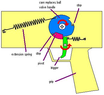

The problem is that a ball valve is very hard to control for multiple shots. Here's a rather simple design that can be made using basically plywood cams and levers on a wooden plank base.
Pulling the green trigger will open the ball valve momentarily, then a spring will shut it again. Releasing the trigger allows a second spring to reset it (going past the pink pivoting section on the blue cam) and the trigger is ready to be pulled again.
It's not as complicated as it looks and will give you a fair amount of shots, you can tweak it to open more to trade shot count for power.

Could I do this out of acrylic? Il have to search around for some strong springs too, as I dont have any.
Acrylic is brittle. Use polycarbonate instead. (Lexan)
Technician1002 wrote:Acrylic is brittle.
True, but as long as there are no hammer-type impacts involved in the mechanism it shouldn't be a problem. In the design I posted the only impact area as such is the stop for the blue cam, but considering ball valve friction it likely won't be travelling fast enough to cause damage.
