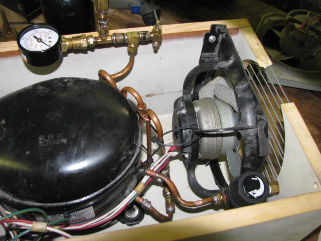

O.K. Guys I threw the old compressor away. A neighbor was throwing out 2 old fridges so I got the compressors out of them. And I think this is really funny, there was an argument in a thread somewhere in Spudfiles a while back about using fans to cool the compressors and if it would even help, well both fridges had a fan installed to cool the compressor :lol:
I got one compressor that looks like a typical normal looking compressor and it works fine, the other compressor is a cylinder about 3.5" dia. x 10" tall. well it is very low on oil so I hooked it up electrically and plugged it in and all it did was hum, I guess the piston was stuck, it was not turning, it did this till the thermal thing kicked on and turned it off. I did this 2 or 3 times and it finally started spinning, but you could tell it was pretty dry inside cause it was noisy and sounded rough and a lot of oil sprayed out with the refridgerent gas when I cut the copper lines.
So does anybody know what kind of oil is in these compressors and how can I refill it? And how do I know when it has enough?
I figuered I could turn the compressor on and let the inlet suck the oil in.

Looking good, I would still have the lid on and have the opposite end of the box ventilated, in order to create a duct which would increase airflow over the compressor.
You can probably use an oil for air compressors
Find the data sheet and check. You'd probably have to check its mass too and then weight it... if it is 300mg lighter than it should be then you have to add 300mg of oil
I figured I could turn the compressor on and let the inlet suck the oil in
That's how I do it

yeah I just finished the lid today and will install it hopefully on Monday.
I guess it would be better to vent the opposite side, I thought I would mount the lid on 3/4" spacers so that it will vent out the top.
good idea to check the weight of the compressor and add oil till it gets to that weight.
You guys reckon it would be fine to use 10w 40 motor oil?

10W-40 will probably be just fine. Just don't ever use the evil WD-40.
