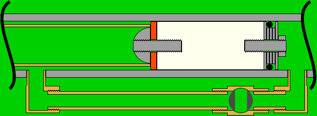

I've only seen it done a handful of times, but, with a completely sealed piston, equalization can be accomplished by simply running a piece of pipe or tubing from the pilot area to the chamber, with a ball valve in between.
So, I got to thinking. With the ball valve there, you would have to open to fill, and then close the ball valve before firing.
If the flow between the pilot area and chamber with the ball valve open is greater than the flow of your pilot valve, this would also act as a safety. As long as the ball valve was open, your pilot valve couldn't drop the pilot pressure enough to actuate the piston.
Of course, you could always add an inline check valve instead of the ball valve for no safety and automatic equalization.
Not the most bulletproof safety, but I believe it should work.

- This is a completely sealed piston with equalization accomplished with a ball valve and some 1/8" pipe.

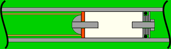

- This is a standard piston with one-way equalization accomplished by a floating o-ring.

I don't think that shape could be made with threaded fittings. It is a solid method of creating a safety though.

It will work. Too large of a leakage path past the piston is often a noob reason some air cannons won't fire.
The ratio of the OD of the piston to the diameter of the barrel seal will play a large role in how much lower the pressure behind the piston must be before the piston will move. The closer the valve seat is to the OD of the piston, the lower the pressure in the pilot must drop before it will fire on a barrel sealing valve.
The drawing above shows a good example of a large diameter seat in relation to the OD of the piston. It won't take much bypass leakage to prevent that piston from opening.
This WiKi page has more information on the relationship of the valve seat to diameter and the pilot pressure drop required to open it.
http://www.spudfiles.com/spud_wiki/inde ... mon_traits

Good point, although in practicality terms I would have used tubing anyways.Gaderelguitarist wrote:I don't think that shape could be made with threaded fittings. It is a solid method of creating a safety though.
I build most of my valves using this principle. My early valves needed a fairly large pilot valve since I used no o-rings. The valve I've made most frequently is a 2" piston 1-1/2" barrel size (in PVC), and this one is no different. (My copper launcher used a 1" piston and 5/8" OD seat, though, which is why it was much easier to pilot with a small ball valve.)Technician1002 wrote:The ratio of the OD of the piston to the diameter of the barrel seal will play a large role in how much lower the pressure behind the piston must be before the piston will move. The closer the valve seat is to the OD of the piston, the lower the pressure in the pilot must drop before it will fire on a barrel sealing valve.

@ Mark, I've seen it done before, but it is a good idea. Still I don't think it's worth it when you can just make a built in check valve with floating o-ring, which is what I always so, but sure it's another option.
